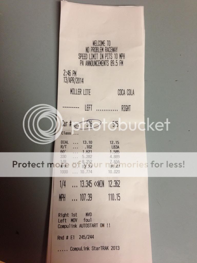

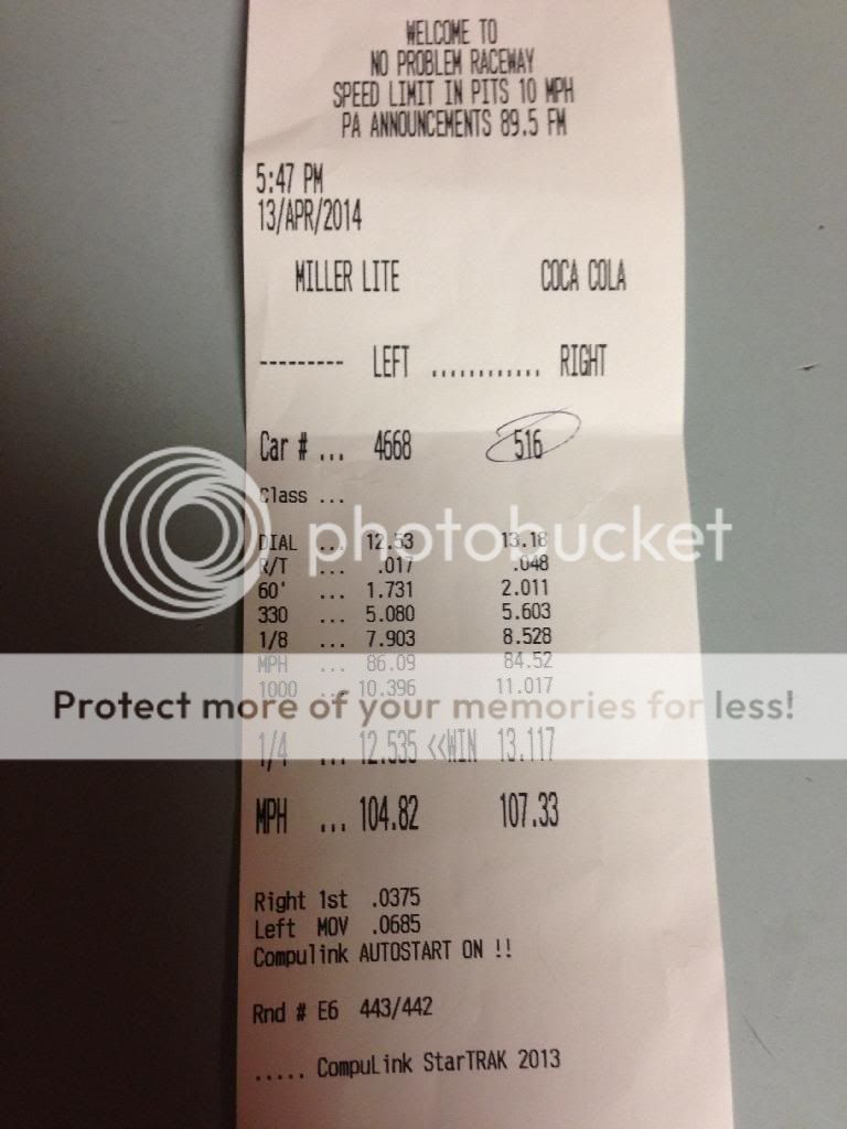

First picture is the slip from today with my best 60'. The second picture is the slip from my fastest time and also my second fastest 60'. I just so happened to run my fastest time in the finals, broke out and came in second.

My 12.37 slip to show you were your numbers are off (like your 1/8 mph is very low):

There's no way in the world that car cut a 1.60 60'. That slip is incorrect.

Yeah that 1.6 is a fluke that slip would make sense if you were 1989 Mustang GT 5 speed launching on slicks.

The numbers from the 60ft to the 1000ft are all wrong the only number that might be right is the 1/4 mile and mph.

I couldn't believe it either. But I did one of the longest burnouts I've ever done and I felt it hook when I took off. Not sure what happened.

Yeah that 60' does seem strange. I definitely felt my car hook more than it ever has. Lethal Racing tuned it.
