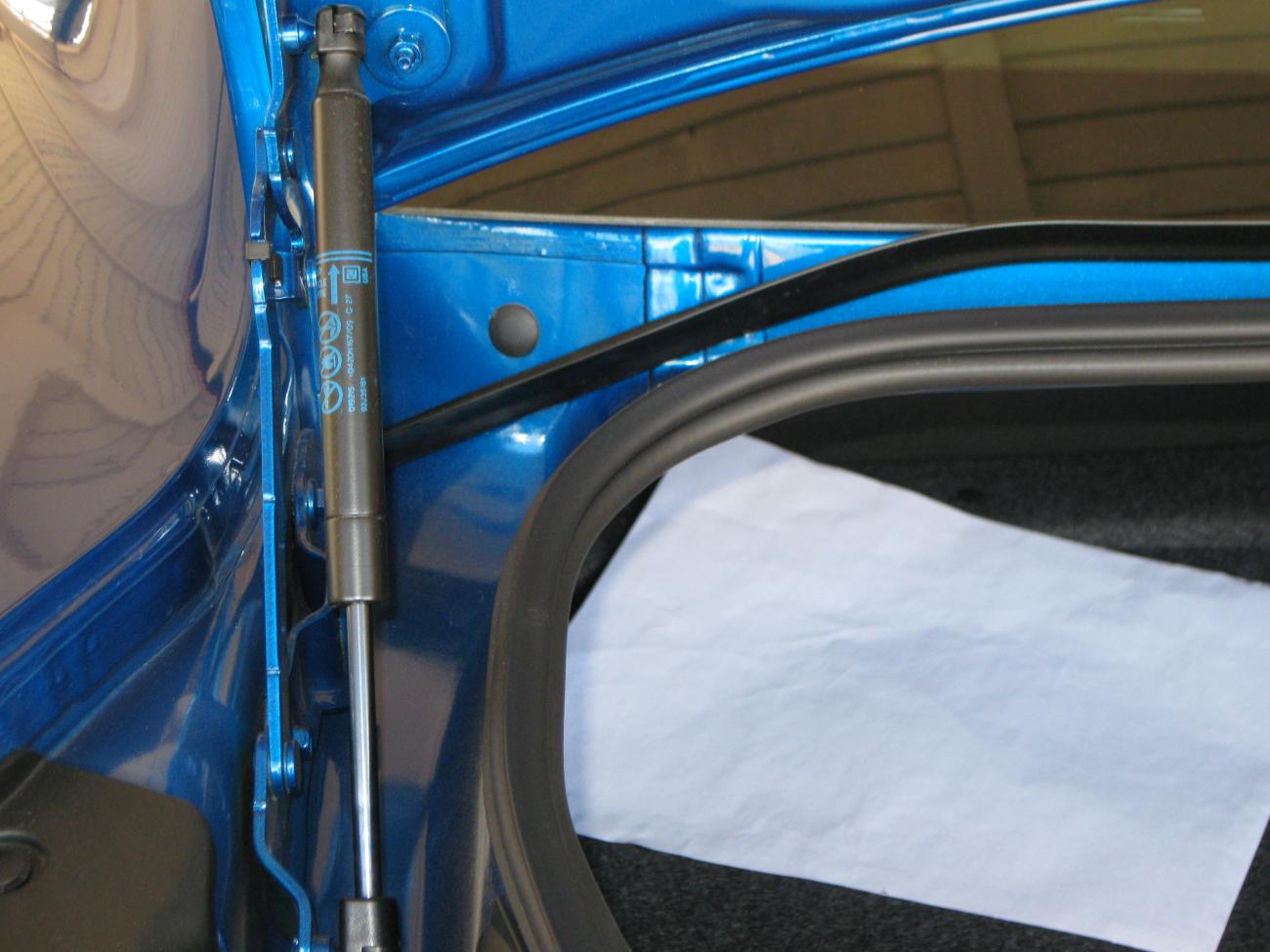

I got one. Just discovered after coming back from the shop to fix a tranny fluid leak. At least the spoiler's not loose.

Thats the EXACT same issue i have. Same place, same disatnce of the rubber lip pulling off.
