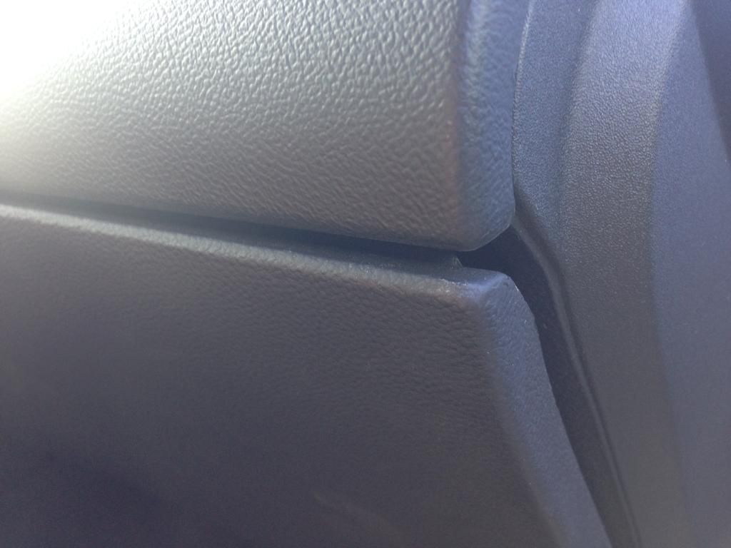

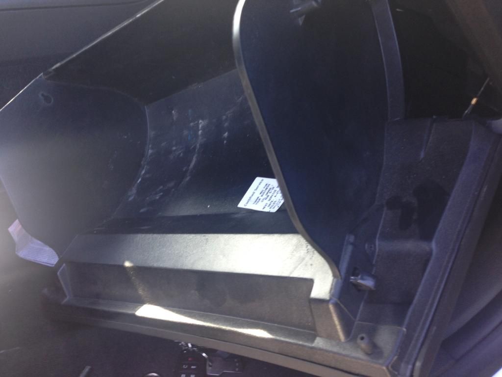

you are aware that the glovebox in the Camaro is an all in one (i.e. physically the same part) design, and there is no way to tighten the hinge as it is nothing more than a molded plastic part that snaps together right?
there is no frame (the molded dash board is the frame)
there is no door the box/door is one piece.
it is a single piece of molded plastic.
the sagging isn't a result of a crack, it is a poor design where in one side of the box is heavier than the other, because the "door" part of the box overhangs on one side and not the other.

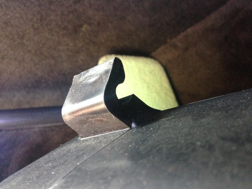

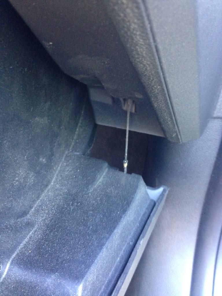

So to combat the issue GM put a little piece of elastic string on the passenger side that takes the slack of the off balanced weight, and if said string breaks (or more correctly the plastic attachment that holds the string to the box breaks) then the box sags on the right side, because it is off balance due to the design of said box and the location of the plastic snap hinge which are not evenly centered on either side of the box.
all in one design, no separate compartment and door:
plastic snap hinge, no hinge pin to tighten or replace:

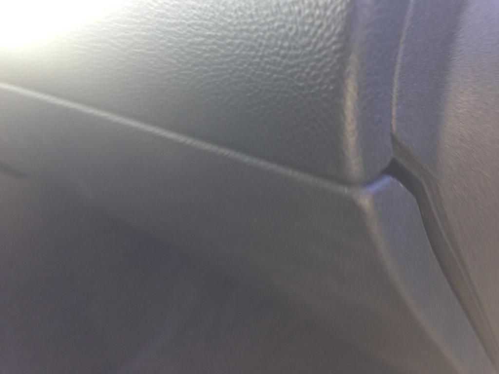

saggy door/box:
instead of a nice cleanly closed box:
caused by this being broken or dislodged:
