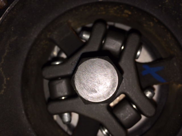

Installed both of these to my otherwise stock 2014 ZL1. The install
of the CAI, Inc cold air intake system was very easy and straight
forward. I installed the CAI first and drove it for a few weeks. I
was very impressed with the performance boost and overall improvement
in the sound of the supercharger.
I ordered the ATI Super Damper and 5% pulley from JRE. The install
was fairly simple but it was more complicated than the CAI. I've had a
lot of automotive mechanical type experience over my career which
gave me an understanding of how to do this. I only needed to remove
one single part from the FEAD (an idler) to gain enough room to get
the stock damper out of the front of the engine compartment once it
was off. I ended up renting a puller to get the stock damper off.
I made my own install tool, after reading a few threads from people
here on C5. A trip to Ace hardware was all it took. Some threaded M16
x 2.0 rod, a few spare nuts, washer and a bearing is all it took.
Picture shown below.
All in all the damper install took about 90 minutes. The assembly of
the ATI damper took a few minutes to figure out and required a call to
JRE. They were very helpful. The installation orientation of the A/C
pulley was not initially clear to me as I didn't have the stock damper
off the car yet. That would have helped. Anyways, the JRE guys
answered the phone and emailed me some pics which were very helpful.
For those of you considering doing this install yourself, I would say
take your time. One thing you need to make sure of is that you do not
mess up the nose of the crank in any way. That would be expensive.

Stock damper with bolt removed.
Stock damper with puller properly installed for removal.
