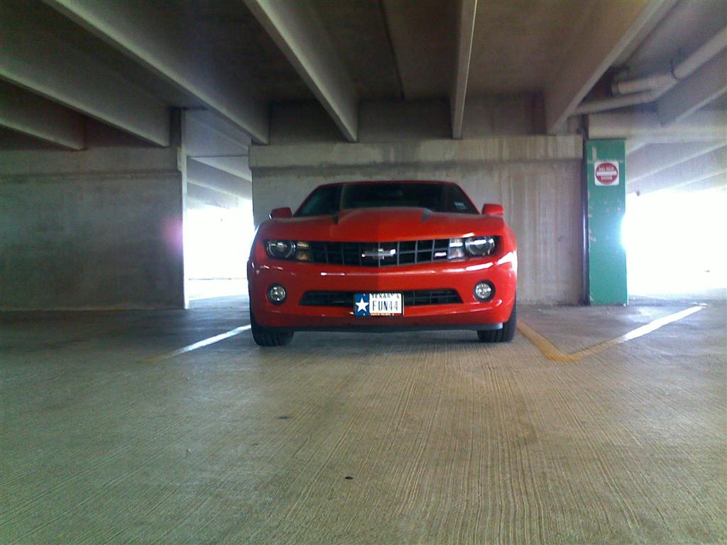

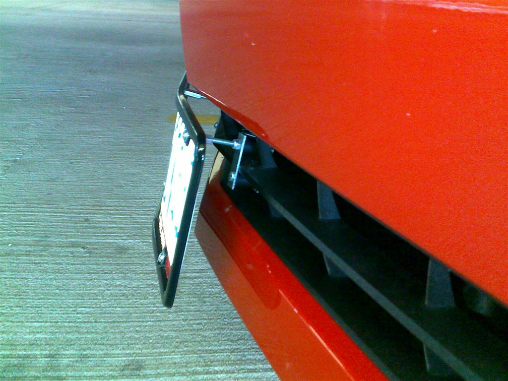

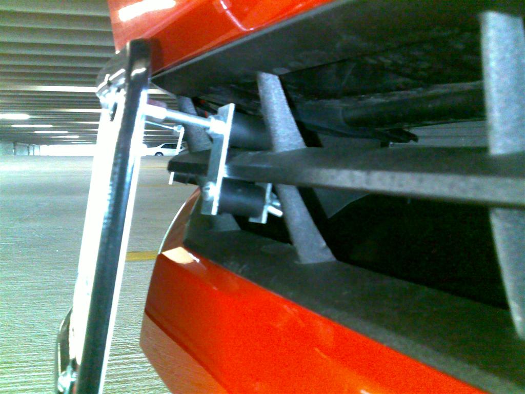

I was going to wait to post what I did for my front plate until I had it all painted black but here it is. Sorry for the crappy cell phone pictures.
I made 2 brackets that mount to the center cross-bar of the lower grille. I used four 2" mending plates with longer 3" bolts through the top holes and shorter 2" bolts through the bottom holes of the plates. I put a 1" plastic spacer on the bolts between the plates to kind of center the brackets on the cross-bar. On the longer bolts, I put a 3/4" coupling nut on the end and then used 1/2" bolts to screw through the plate into the coupling nuts to hold the plate on. The top bolts are inserted from the back and face outward. The lower bolts are inserted from the front and face towards the radiator. The lower bolts are held in place with a wing nut so I can remove those and take the entire bracket off when I want to.
I still need to adjust it a bit because it is still a bit more angled than I want and sits a bit too far away from the lower lip of the fascia for my tastes. After about 1000 miles, it seems to be holding up well without doing any damage to the grille or fascia.
