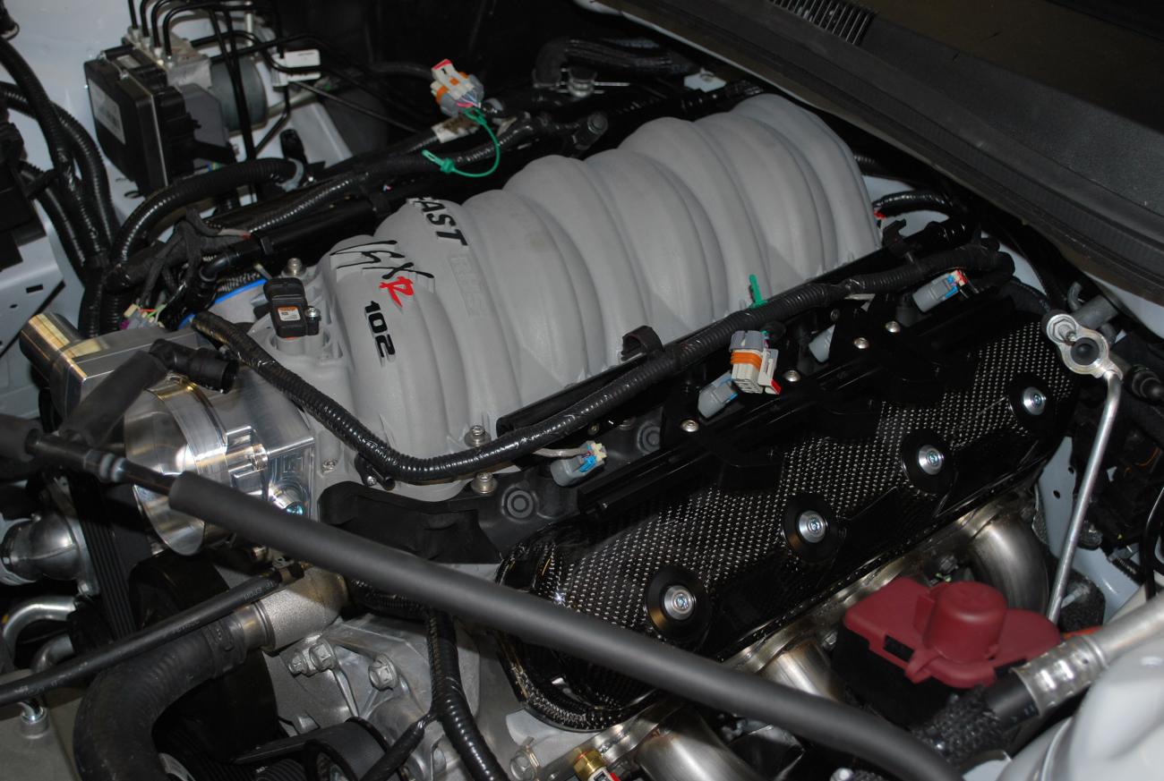

I just finished working on my 2014 White Z/28 modifying it a bit
NEW PICS AND VIDEO OF CAR WITH FINSPEED WHEELS ADDED POST #69 and #70
INTERIOR PICS ADDED POST #47
Rear seat delete/bulk head, Roll bar (paint match white, just covered in protective padding still as I finish it up), Sparco Seats, and Schroth Harness'
FINISHED INTERIOR PICS ADDED POST #59
Parts List:
Fast Intake LSX 102
Billet fuel rails
Custom Fuel Lines
Nick Williams 102mm TB
ARH 1 7/8 Headers w/3" exhaust to axle (For the Z/28 Just released 2 weeks ago) - using stock mufflers (No Drone and very docile/quite at cruising speeds - stand on it and she definitely say's HELLO!!)
ATI Damper
Lifters
Push rods
New Katech Track Attack CNC ported Heads (With Ti/Mo intake and exhaust valves)
Katech Cam
ARP Head Studs

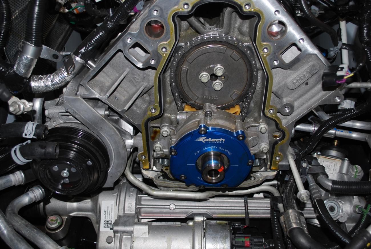

C5-R timing chain
Katech High capacity scavenge ported oil pump
Tilton carbon triple disk clutch/flywheel (saved 42 lbs)
Plug wires
coil relocation kit
Katech Carbon valve covers
Wheels:
Finspeed - 19 x 11 FRT/ 19 x 12 RR F5 Spyder wheels with all lightning options Black Ceramic.
http://www.finspeed.com/
Suspension
Rear - BMR - trailing arms, toe rods, sway bar, lower control arms, and Detroit Speed Sway Bar links.
FRT BMR - sway bar links and sway bar
Hotchkis Chassis Max Brace
Interior:
Sparco EVO ll seats
Schroth Profi ll 6pt hans belts
RPM roll bar paint matched to factory white
Rear seat delete/bulk head (Panel by RPM)
Proven Wicked - Steering hub adapter
Sparco - quick release steering wheel hub and R-383 steering wheel
Work Performed by Auto Tek Inc. in Austin, TX
www.autotekinc.net
Tuned By Patrick Guerra
LSX Performance Dyno Tuning in Victoria, TX.
www.LSXDyno.com
Dyno Chart at bottom of this post as a PDF
Stock - 445WHP/397TRQ
Mod - 607WHP/517TRQ (check out how it carries the power till redline)

More pics
More Pics

I have used Tilton Carbon ceramic clutch/flywheel set ups in 4 of my previous builds, all with great success. Remember, it is a race clutch set up, it is just a bit sensitive/grabby on take off but other than that it is all bonus from there
If someone is getting harmonics it must be from something not installed correctly, could be several things: Run out on bell housing, clutch not disengaging all the way, air gap at installed free height, etc.......
Note i also put an ATI Harmonic Damper on the car due to it revs much faster and will be run much harder than in stock form.
With a small 7 1/4 clutch set up, you almost have to go the carbon version (mine is) otherwise the metalic version is just to WAAAAYYYY to grabby to get the car to drive off from a stop without a allot of RPM and clutch slip. Then the metalic plates do not like that kind of heat from the slippage and they warp. The Carbon version does not mind it at all.
