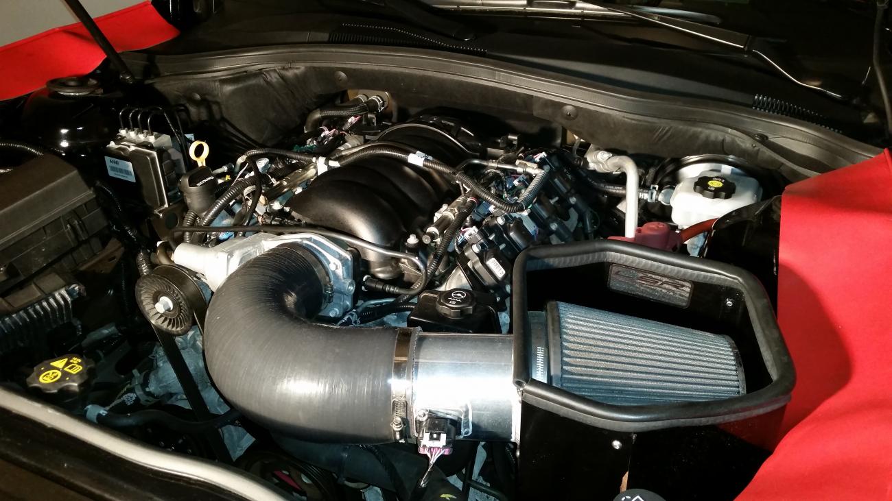

Well my Camaro has sat outside my house for the last month while I've been away travelling for work. I get back and check all the fluids before I start it, just as I always do when I get back from a trip, and find this:

I didn't find a nest and no wiring or hoses have been chewed (thankfully). But I'm definitely going to replace the insulation. But what really bothers me is there's an acorn or something inside the hood that rolls around when I open it. The nest could be inside the hood but there's not way to see inside it to find out, as well as no way to get that damn acorn out.

Went to my dealer parts depo and got all 3 pieces ordered. $41 delivered to the dealer on Thursday. Not too shabby. And It looks like installation won't be too hard either as these pieces are just at the top of the engine compartment and don't extend all the way down the firewall.

Got the firewall insulation replaced. The insulation is 3 pieces. The driverside was easy, the engine one had 2 hidden plastic clips at the bottom that I had to go feeling around for, and passenger side was complicated. The brake lines, heater core lines, aluminum heat shield, and the contours make for a tough install. I wound up ripping a small part of it behind the brake line retainer clip. Luckily that part is hidden, you'd only see it if you pulled the engine.
