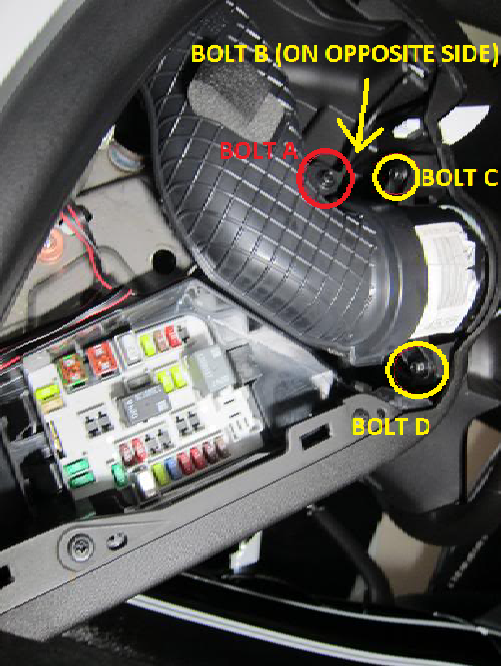

1. Ok so start by taking the driver side fuse box panel off (it just pops right out) and remove the bolt securing the air duct (BOLT A). Pull that duct out.
2. Remove the three bolts holding the vent assembly in place(BOLT B, BOLT C, AND BOLT D). There is a bolt on the top, bottom and on the side. The side bolt is kind of tricky as there isnt much room to work with and

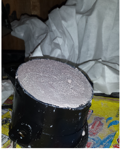

4. Fill her up with bondo!! I filled mine a little past half way. Adjust as necessary for your specific gauge. Fill the vent with bondo face down on a clean flat surface. I used a magazine cover. When it dries you have a nice flat front side. Should look like this when done.
******It is very important you get the ratio right when you mix your bondo! If you put too much hardener in the mix, once it dries, it will be very brittle and might crack during drilling,and sanding stage. Get your ratios correct and mix well*******

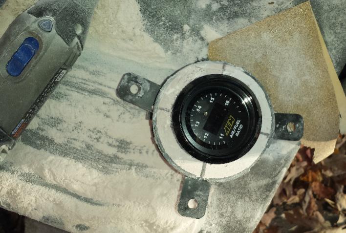

5. Once that is dry (should be dry in about 20 - 30 minutes), find the center of the bondo'd area as shown. Measure the diameter of the gauge (not the bezel ring on the front of the gauge, but the opposite end of the gauge itself). You want it to be small enough to slide the gauge in your hole and then have the gauge bezel/cap cover up the edges of your hole so it looks clean.

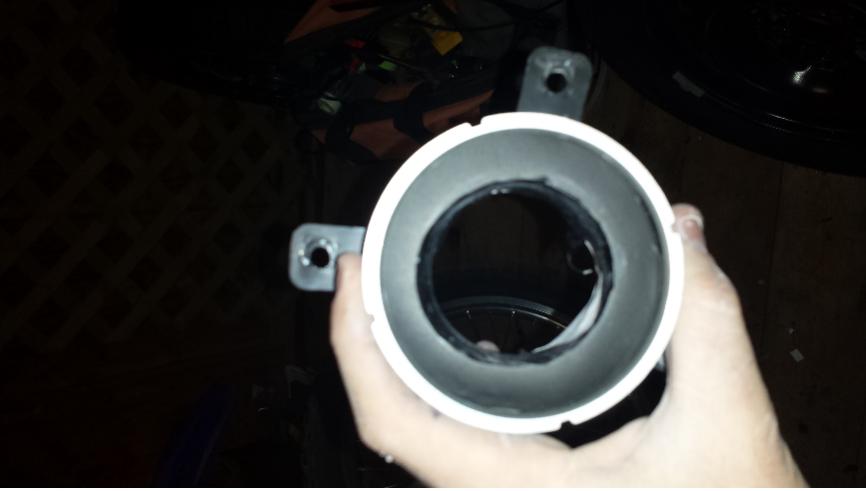

6.Once you find the center and mark your circle, use a drill to get a hole in the center. Then use a dremel or however you wish to widen the hole to proper size. Always start small and check the fitment of your gauge frequently.

7.Once you are able to slide your gauge in the hole and are done widening, clean up rough spots with sandpaper until you have a smooth surface. Use fine grit to finish.
