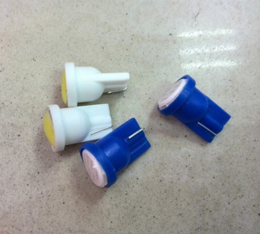

T10 bulbs (I have 2 in each foot well) single chip in each, search "ice blue t10" on ebay and there are hundreds, I paid 6 dollars for 50 of them shipped to my door.

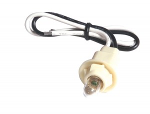

Next up you need the pigtail they plug into, I used 4 of Grote partno: 68380. These are available at any local heavy duty truck parts place, you know tractor trailer parts. Or often you can find similar pigtails off ebay, I knew these existed through Grote from my days of working on the big diesel trucks so that's where I bought em. These are the same socket that is in the dome light of the car.
http://www.grote.com/family/twist-in...t-pigtail-194/
[These dont have adhesive or anything so mounting them requires getting creative with zip ties instead]
