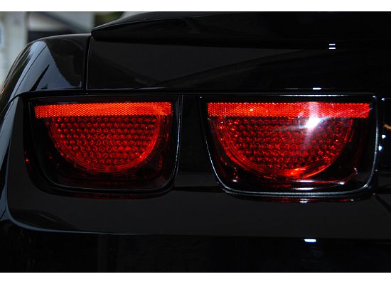

I only removed the 2 covers off the top - with the 3 posts in each one. Then, using just my (small) hands, removed each trim ring. Very easy, and only bent 1 tab - my first. I spray painted them, and put them back in. 1 small crease of paint in 1 corner than I will sand & repaint tomorrow:
Closer shot:
