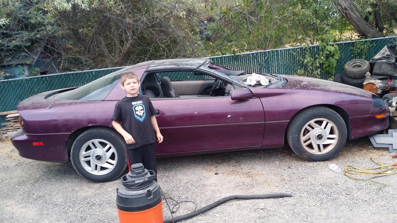

95' Goes forward in reverse and rolls in park when off.
Just picked up a my first Camaro. Its a 95 with the 3.4 Auto and t tops.
Rolls in park when off but not running,
Reverse is park when going from park to reverse, reverse goes forward when coming from the neutral spot.
No neutral (goes forward).
The center console in currently removed and was found jam packed with cigg butts (Now cleaned up).
Any run into this? Ideas what it could be? I was leaning toward shifting linkage but park works when running.
I am Briggs and Stratton MST so I can turn a wrench but I am just stepping into cars.
Thanks for your time and consideration on my issue!

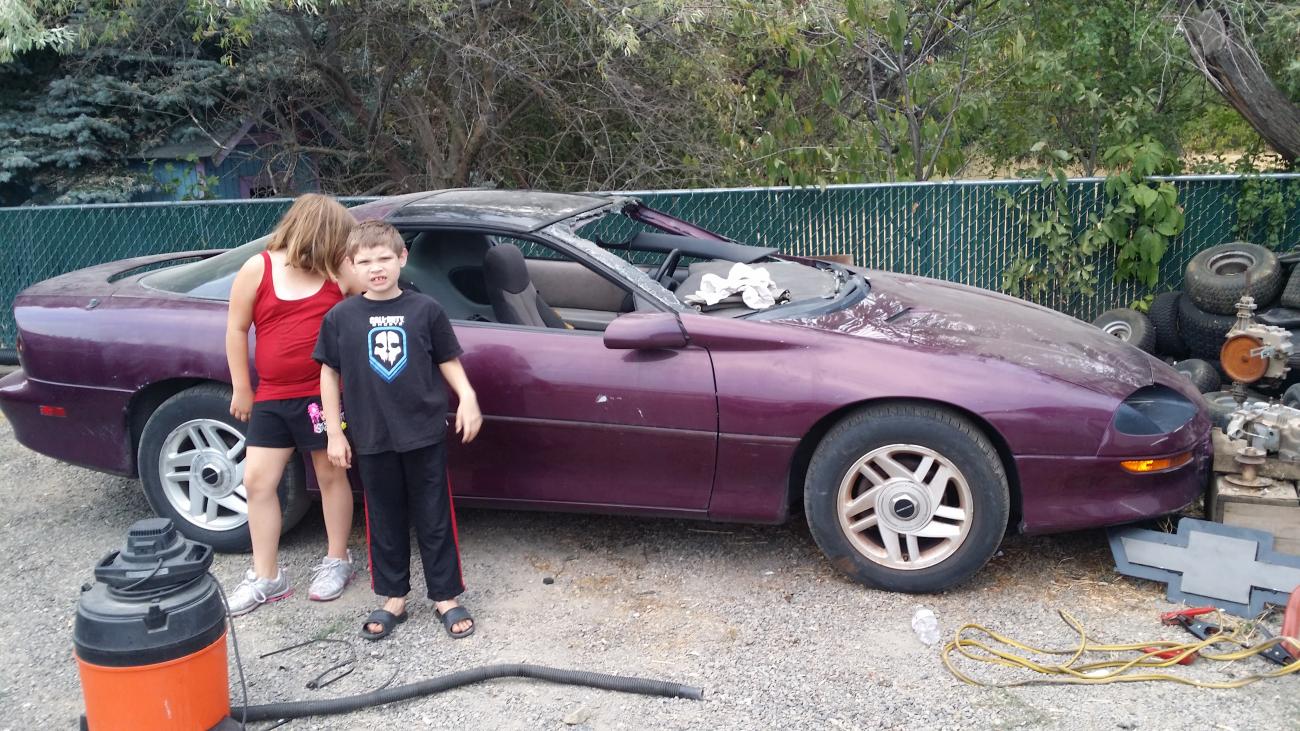

Originally Posted by b4cz28 View Post
Not many 3.4 survivors out there any pics?
From what I hear this was pristine up until the kid I got it from had it. He did this in 3 years.... It has a huge to fix list but if the foundation is solid....
Missing so much, my goal this year is to get it running and driving properly and to replace the windshield, driver door / guts, and Left T top. (It came with 2 rights lol)
Its going to be lots of work but I think well worth it (to me) once she is pristine again.
Both tires left trails on a mini burnout it was so fun!
