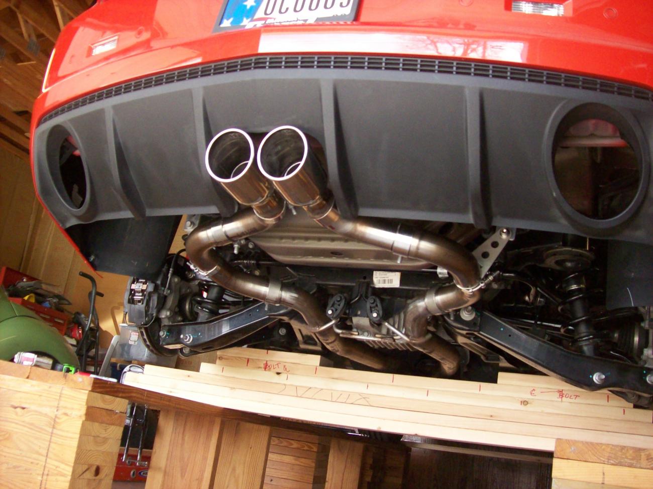

Witch X Pipe did you have installed & where did you purchase it from? This is going to be the next mod on my 2010 2SS/RS Camaro. Attached is a photo of my CENTER EXIT exhaust that I designed.

Orange 2010 Camaro
