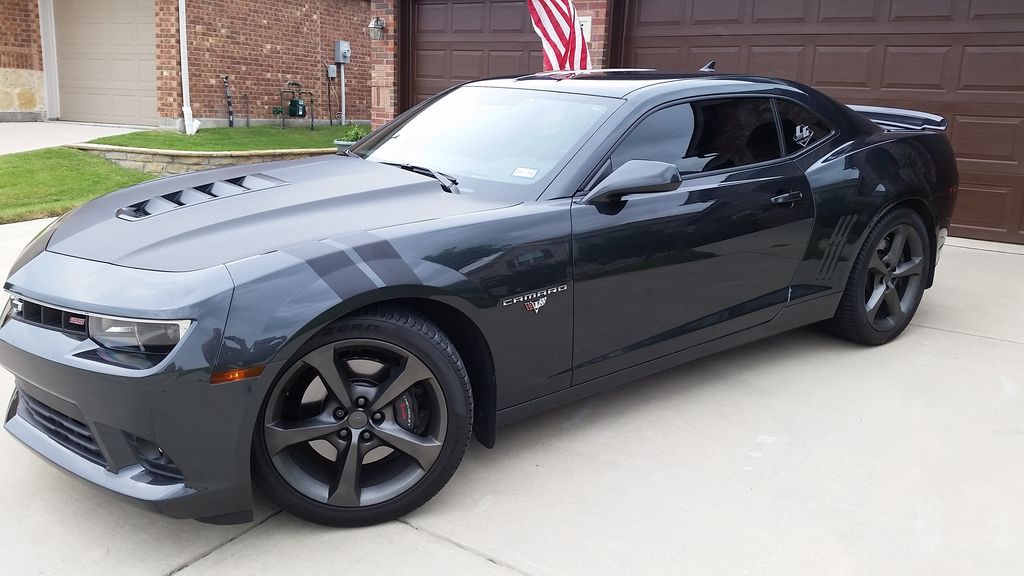

If it was mine, I used matte black with a graphite metalizer topcoat. You need 8 light coats per wheel in total. I did 5 matte black and three graphite to get the look below.

Did them on the car. Used kitchen trash bags to cover the rotors. Followed the dip you car vid they did on a yellow Audi. Just takes time. 15 minutes between coats. Set the timer after the first wheel got coat1, then did the other three. Waited about 10 more minutes, reset and went again.
Pm with any questions. Light coats, and lots of them. Stay the same distance from each wheel on each coat to keep it from getting run or rough texture.
