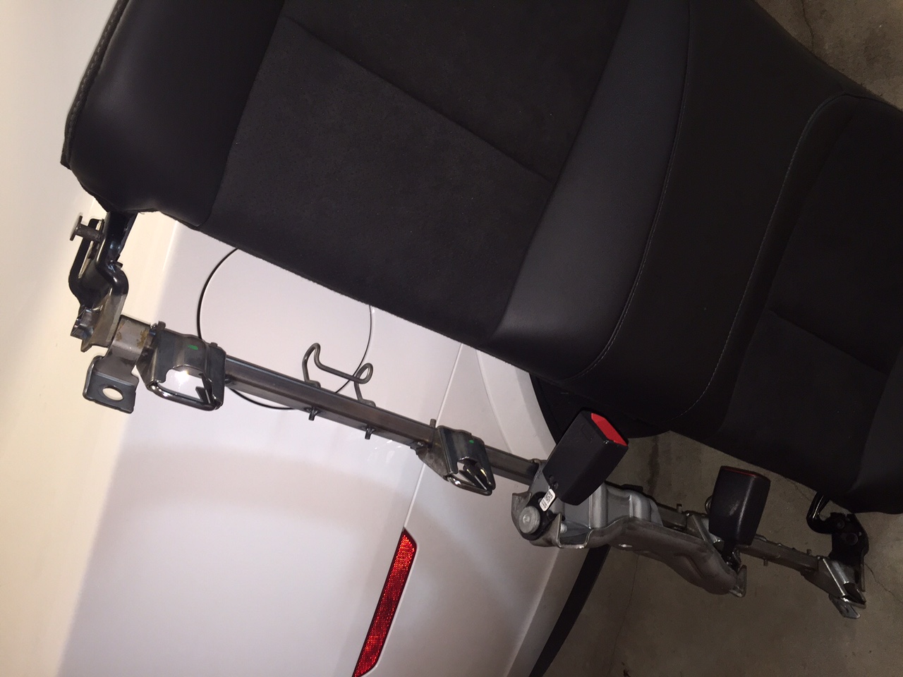

I removed the rear seat and the back cushion, which turned to be fairly easy task. The primary purpose it to be able to carry another set of wheels to the track so I can really use these tires to their full useful life.
The back cushion swivels over a structural part that is attached on either side and in the center and provides support for the seat belt center attachment points and optional child seat.
I ran across the following in Automobile Magazine: "Interestingly, the Z/28 retains a rear seat because the car is lighter with one than without. “The rear seat is part of the structure, so when you remove it you have to compensate with bracing,” says Al Oppenheiser, Camaro chief engineer. “You can easily end up with a car that’s heavier than it was when you started.”
Looking at the area where the seat was, I see no reason to add additional bracing but than I am no expert in this area.
Anyone knows more on this topic?
I am attaching 2 pictures showing how clean the are is after the seat removal, and the back cushion with the structural bracket
PS: The rear seat weight (bottom and back cushion including the seat bracket weighs 27 lbs.

Make yourself a copy of the seat bracket out of round aluminum stock or something similar and call it the day...

If the Z28 seat is like the other 5th Gens, I don't see how the upper and lower cushions can be considered structural support. Now on the other hand, the bracket you unbolted and removed, that can certainly be structural support since it spans a good portion of the width of the car and could stiffen the sheet metal shown in your picture. I agree with Olblue75 and make something lighter, but bolt it into the same place as the original steel bracket.

Agree with that right there. Seems like a dual purpose piece if you ask me. For the seats and the chassis.

If it is indeed a support for the car to reduce flexing wouldn't it would need to be connected to the shock mount areas to provide stability to reduce flexing. If you remove the rear seat as I have done in my ZL1 wouldn't I hear creaking from having removed the piece? The "chassis brace" concept but in reality not needed.
I would equate his statement to the possible actual usage of the back seats by passengers and provide support to the floorboard with added weight in that specific area. That area is reinforced on the sides to begin with. Remember the Gen 5 chassis photos with explanation of materials used and reinforcement.

Thank you for the replies. For now I installed the structural bar back. It does look as though it provided multiple purposes: It has the hinges for the back cushion, it provides structural support for the seat belts and possible it ties the 2 sides of the car together. Once I can see what's below it on the underside of the car, it could reveal if indeed it has car structural purpose.

I can't imagine it adding much rigidity to the car. There are some pretty big beams running very close to the same proximity of the seat bracket. At best my thoughts would be it controls some NVH. I think they just wanted to leave the seat in rather than remodel the entire rear upholstery and just told us it was needed for strenght. Who are we to really know better anyway.
