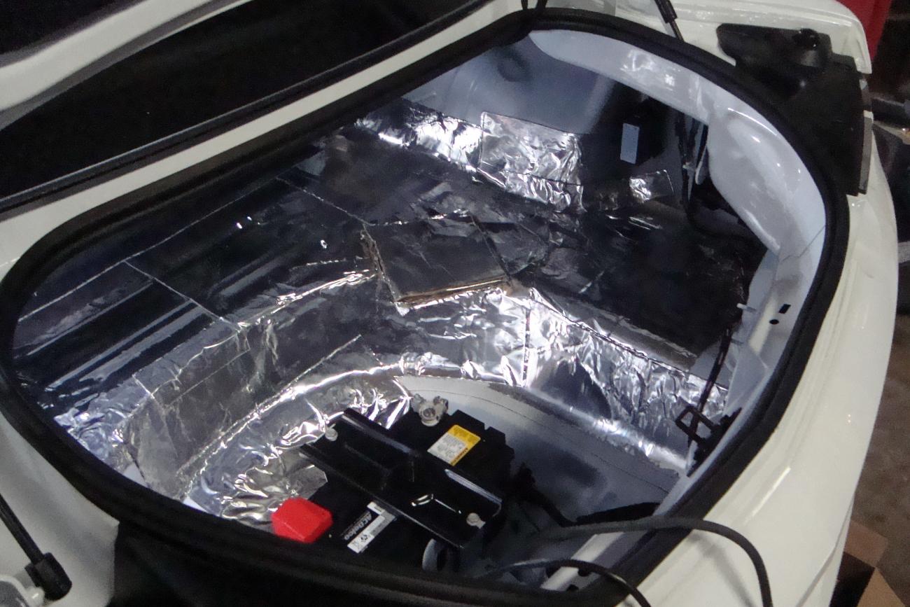

In looking for tips and advice from people who have used sound deadening material not just in the trunk but the whole cabin. I'm thinking of pulling seats and all carpet and doing from firewall back to the trunk. I'm not 100% on which I'll buy yet. The stuff I looked at before was 1ft by 2ft. So for those of you who have done it, how did you do it? Have any pictures? Did you just start at the edge sill on driver side and go across? I've never worked with any sound deadening material so I'm a complete noob. Thanks

Yes, used 3 of those "9-sheet" packs of Dynamat Extreme (115 sq ft) and 2 rolls of Dyna-liner (24 sq ft) on Amazon. Had a retail car audio shop try and charge me $2,000 for 5 (DE) + 3 (DL) packs and installation so did it myself, discovered they were price gouging and looking for an easy profit. Cost me less than $550. There is nothing "relatively cheaper" that works as well, your results will be exactly what you pay for.
You're not pulling the carpet up, it's attached to the front firewall under the dash somehow. After the center console is completely removed, the carpet will lift like a bathroom tub from one side of the car or the other and you can lay Dyanamat underneath. I had help that day and was still cussing wildly, its a pain.

Ever try to take a piece of paper and wrap it around three corners at once? Does not work well. The first 20 hours I spent trying to cut perfect pieces and making everything look good - waste of time for the most part. The next 20 hours I took the single sheets (18" x 32") and cut it once down the middle (9" x 32") then cut those into 4" wide sections (9" x 4"). Took each section and started throwing them into crevasses at that point. Don't get me wrong, for the large flat parts of the car, easy.
[Enter company here] will try and sell you some special tool or roller to lay the crap in the car with.....really only useful on flat surfaces (not many). Go buy a can of tennis balls (seriously), between the felt surface, air pressure and curvature they are the perfect tool for rubbing the material to the metal of the car.
This is one job you do not rush, will take 30-40 man hours. Time does not cut in half with two people, but it is certainly much easier with two. One person can be cutting sheets while the other is upside down backward preparing for kamasutra reaching for holes.
