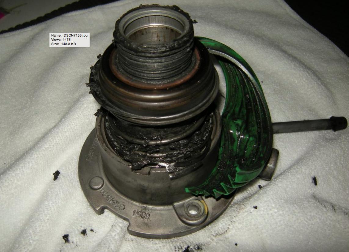

I run a ACT dual disc and love it. If you change your clutch do yourself a favour and replace the plastic GM bearing support with the Monster Clutch billet piece.

This is what the slave look's like when the plastic GM bearing support fails.
Attachment 748264
Wow nice piece I can really see the difference between the two. I'm definitely going to do that upgrade along with the remote clutch bleeder. I'm going to have to consider that clutch too. Did you notice a difference in the 1/4 Mile at all going from stock?
