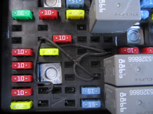

but the basic part of it is to take a dioed and heat shrink it thin in the fuse box under the hood connect the headlight fuse and the foglight fuse together with the heatshrinked dioed make sure the line on the dioed is toward the headlight fuse(this prevents feedback to the headlights)
i will do a diy on this cause i am wanting to do this myself
i ain't been in the fuse box of a Camaro to see what actually works, but if you can do it like on the trucks, you'll want to jump the relays instead of fuses
after firther review you are correct sir, under the relays
this is my avalanche fuse box without the relays installed
this pick also has the all on high mod and constant day time running lights the camaro will only need one dioed in there
i will do this this weekend and post a diy on it because it drives me nuts to have to always hit that damm button at night it should only take about five min once i get under there

Coming from a Silverado Duramax, I was fishing under the hood today using diodes. Back in the day, the 85 pin to the low beam would be connected with the 85 pin of the high beams, and on to the fog lights. We'd have everything on which was bad ass.
Now, I tried a couple different configurations for this. I'd like to have full control of my fog lights #1, but two, to be able to use them when my low beams are on. Spending a hundred bucks on a harness is kind of a lot when a whole package of diodes can do the same thing for $2.
For those of us with the RS packages, there's a small fuse box with numbered pins, just like on our trucks that I used. The fog light is numbered at 50 and I used those to connect together. So far, nothing, nada.
I'm also not done with this yet. Just ran out of daylight.
This is what we've used before and worked flawlessly for years.
http://www.thetruckstop.us/forum/sho...-Headlight-Mod
The concept has gotta be the same.
