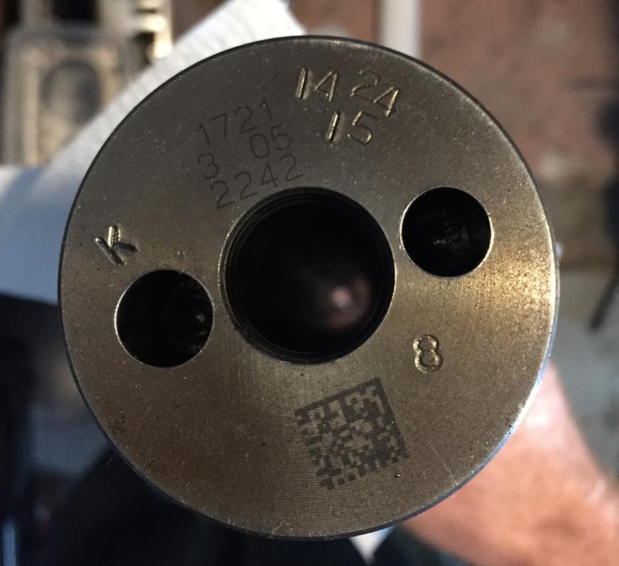

I didn't purchase it but it was a custom grind. This is the ID.

That's a bad one! Do you know where it was purchased? It doesn't appear to be a Comp Cams or a Camotion. I've seen a few reground stock cams with similar markings.

Yep looks like a factory core regrind. He said its a lopy cam, doesnt seem to know whats in it. Hell it may be a hot cam all we know.

If its a single bolt it may be a stock GM cam .... Its bad metal looking to me like the casting had air bubbles trapped below the surface and with the spring pressure those lobes got ate and the appearance looks to be pitted form voids in the metal not form wear of the rollers. You can see some fairly normal tracking in the other lobes. IMO its a bad core.
But also there are other things that can be contributing factors to a cam failing ...sticky lifters/ shot lifters/ shot rollers/ shot rocker trunnions making things bad but yours does not have the even wear around it damaging the cam all around it the other things would contribute to.
I do not think event that breaking in the cam correctly could have saved this cam because of its flaws it only would have maybe made it last longer. SO yes you should get a new cam, and hopefully what little shrapnel you had did not damage bearings surfaces much and just went to the pan.
I use driven racing BR30 for break in of my cars cam, and now new engine. I could show you a pic of my comp cam at ten thousand miles..it looks damn new..... I sold it when my last engine had a over rev problem bite me, and thus went to a stroker.
Occasionally even stock cams I have heard of falling apart, my tuner has done many.

People used to like to blame comp cam for bad cores on here supposedly, only there photos and the truth to me were it was really rare. Often too they were running crappy oil or had contributing factors big time like: no break in of cam, bad lifters, rollers just dragging because the oil was too slippery( sheer rating off).... Really that does matter the rollers have to roll, and other things..... And usually the story was muddled and yours is a pic of what would be under cam failure from metallurgy IMO...
http://www.bing.com/images/search?q=...pics&FORM=IGRE
So good luck to you I would of course recommend you start with the hardest core possible a 8620 and even TSP is making them Harder now than just the standard comp core which was as you can see just fine for me and many others. A bad cam is rare but it looks like you got one..... And that looks like stock one bolt......

Yes the damage is all on the leading faces in the same spots.
I don't know what the cam is. It came in a motor i bought.
