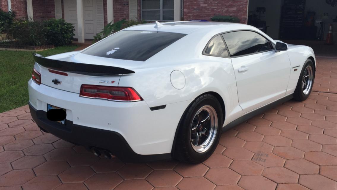

ZL1 + 17 inch Weld RT-S 71 drag pack
Here's my 2015 ZL1 with my new 17 inch Weld RT-S 71 drag pack setup
Rear wheels 17x10 7.2 back spacing
Front wheels 17x5 2.2 back spacing
Rear tires 325/45-17 M&H Racemasters DR
Front tires 28x6.00-17 Mickey Thompson Sportsman Radial
I'm also running BMR 1 inch drop springs & BMR non adjustable trailing arms the only thing i had to do was zip tie the e-brake cables back for clearance

No rubbing issues?

The min rec rim width for those tires are 11 no issues ?

Thanks for all the compliments guys
I drove it a few miles around the neighborhood after I put them on and so far no issues......I drive the car all the time on the street but with a 20 inch M/T drag radial setup
I was about to pull the trigger on a brand new setup from JEGS and at the last minute I found a great deal on a used setup about 4 hours from my house I got real lucky on that one
As far as the wheel & tire setup goes it's pretty much what everyone runs so I don't think there's an issue with running a 325 on a 10 inch rim our other option is the M/T 305/45/17 street R tire
I'll be driving the car to PBIR tomorrow for the street car drags about 80 miles each way so if there are any issues I'll let everyone know.......I'm hoping to get into the 10's my best run so far is an 11.046 on factory fronts and 18 inch vette wheels with M/T 305/40/18 street SS tires
