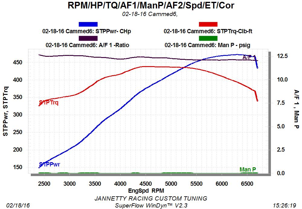

The JRE 470 hot cam works extremely well and very popular.
With Cold Air Inductions cai, Dynatech LT headers with High flow cats, JRE Custom tuning on 93 octane.
473 RWHP 437 RWTQ.
Nice Idle, Great drivability, and strong power, not a dyno queen.
