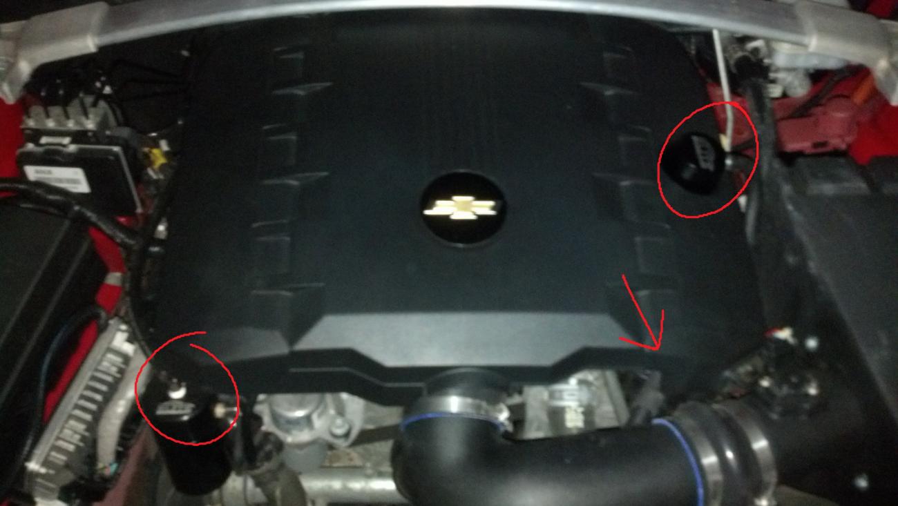

I use a clean side separator from Elite with the catch can to eliminate this issue. Link and picture below. Please ignore the red as I was answering a question.
http://www.eliteengineeringusa.com/c...oil-separator/
Intake manifold is always dry now.
