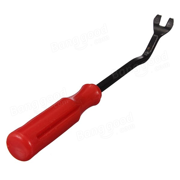

Yes, the trim tool is to pry the plastic plugs at the rear of the belly pan. Rear diff is simple and the right tool is a 3/8" ratchet extension of the appropriate length. Yes, the square of the extension fits in the plug.

trim tool

Is this the same tool required to remove the rain shield from the heat extractor on the hood?

No it is not. The rain shield is held by a two piece resuable plastic rivet. You need to pull the middle out, which unlocked the rivet as it comes out.
