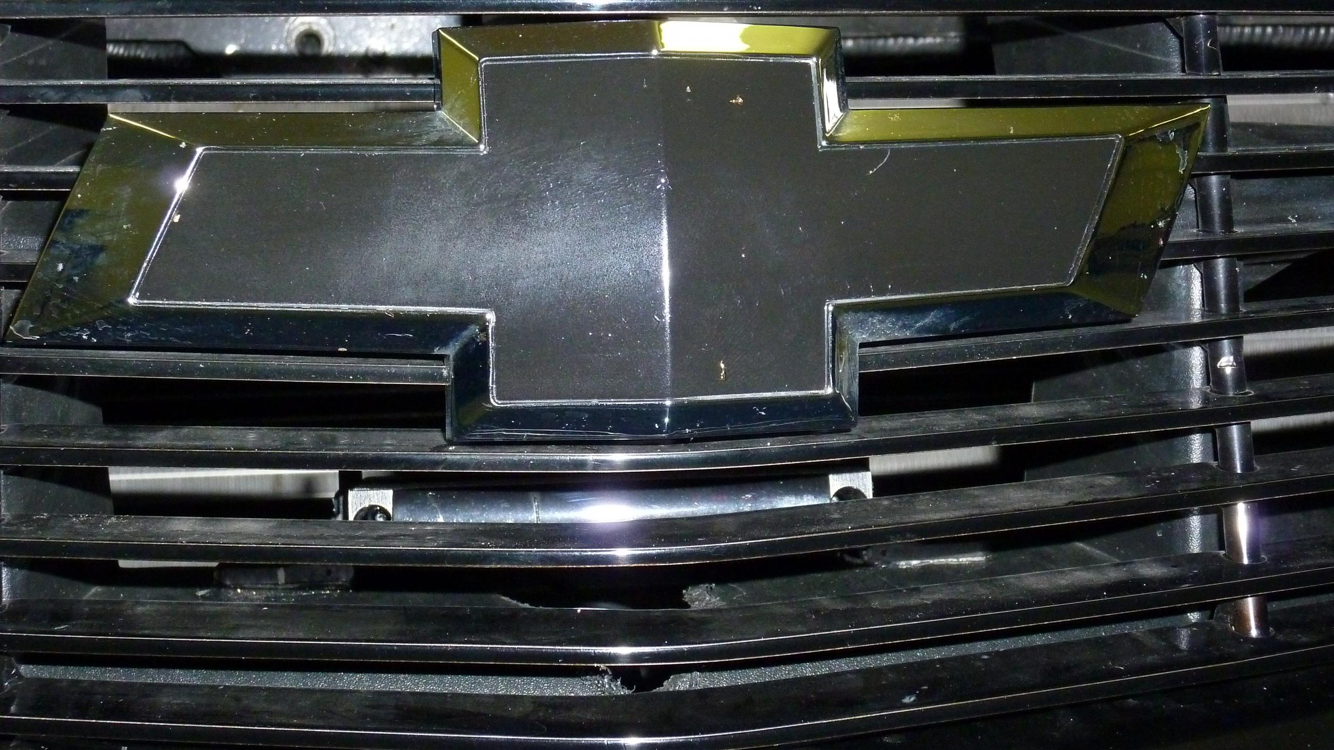

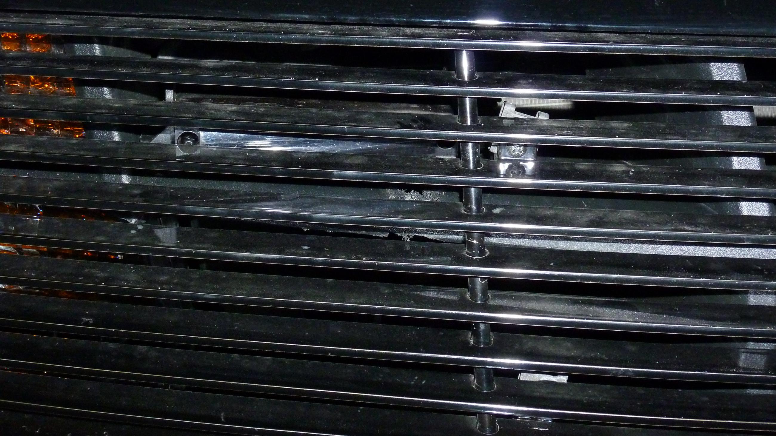

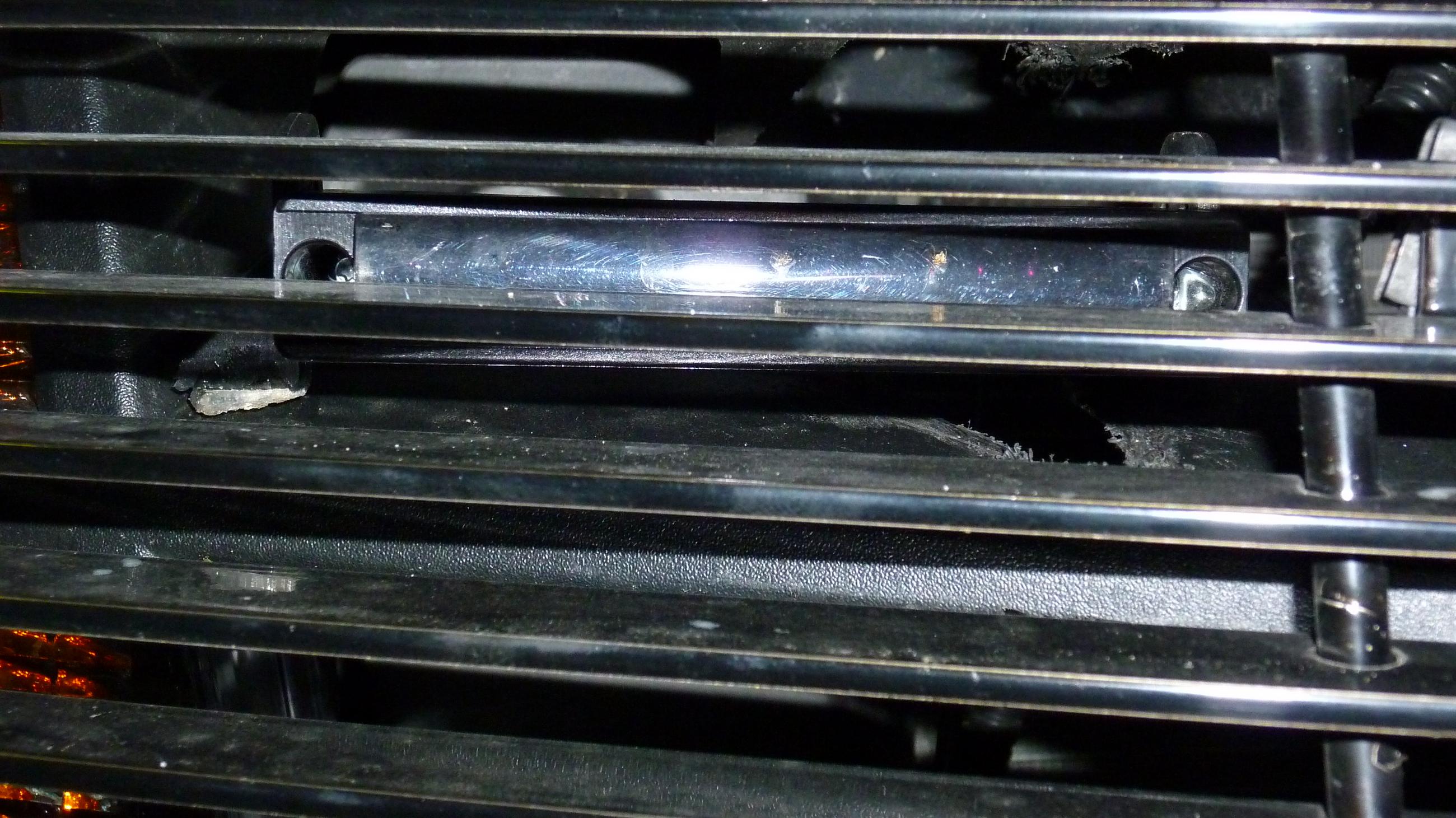

I dont have step by step install pics but hopefully this helps. The transmitters for the laser jammer have to be level to the road. This is the most difficult and tedious part of the install. The kit comes with a level that sticks in the back of each transmitter to ensure it is level but i used a small level to sit on top so i could get a better view of the level. I removed my bumper and had to cut out part of the original grille so that the transmitters would fit, the width of the transmitters are wider than the spaces in between the vertical bars on the grille. This worked well for me because i have the phantom grille. The phantom grille also made it slightly harder because they had to be level and shoot through horizontal bars of the grille. It has already protected me once on the highway, i was going 85 in a 70 and did not get pulled over after being lasered.
Step 1 Take off bumper
Step 2 trim grille to fit transmitters
Step 3 mount transmitters level to the road. You should do this with the bumper on the car. I didnt bolt it back on but let it rest there as i worked on the transmitter mounting.

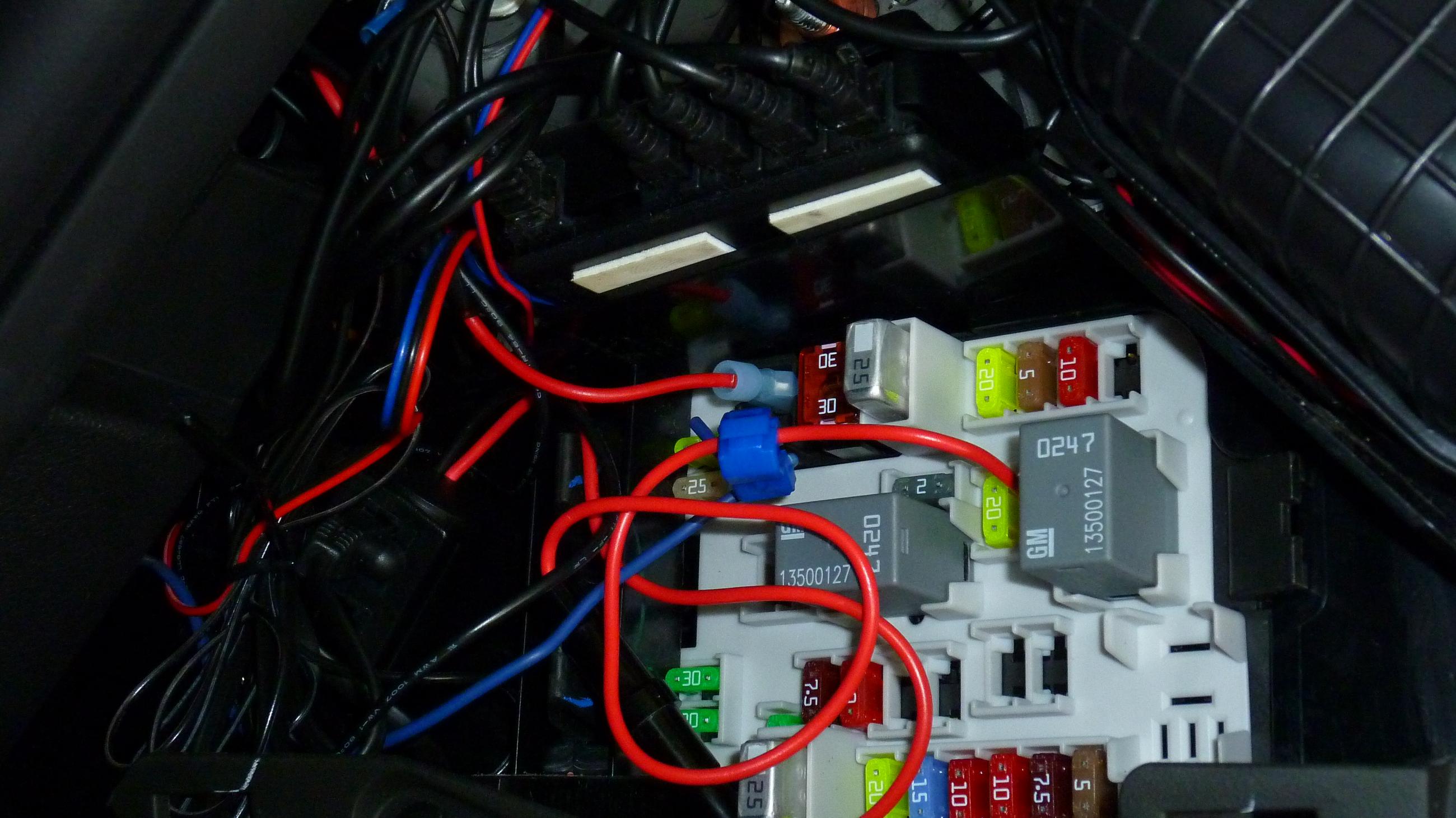

Step 5 find a suitable place to mount and install the receiver module where the transmitter wires will run to. I chose inside the panel on the drivers side where the fuse box is. I wired the receiver module to the lighter so it comes on with the ignition and my Valentine 1

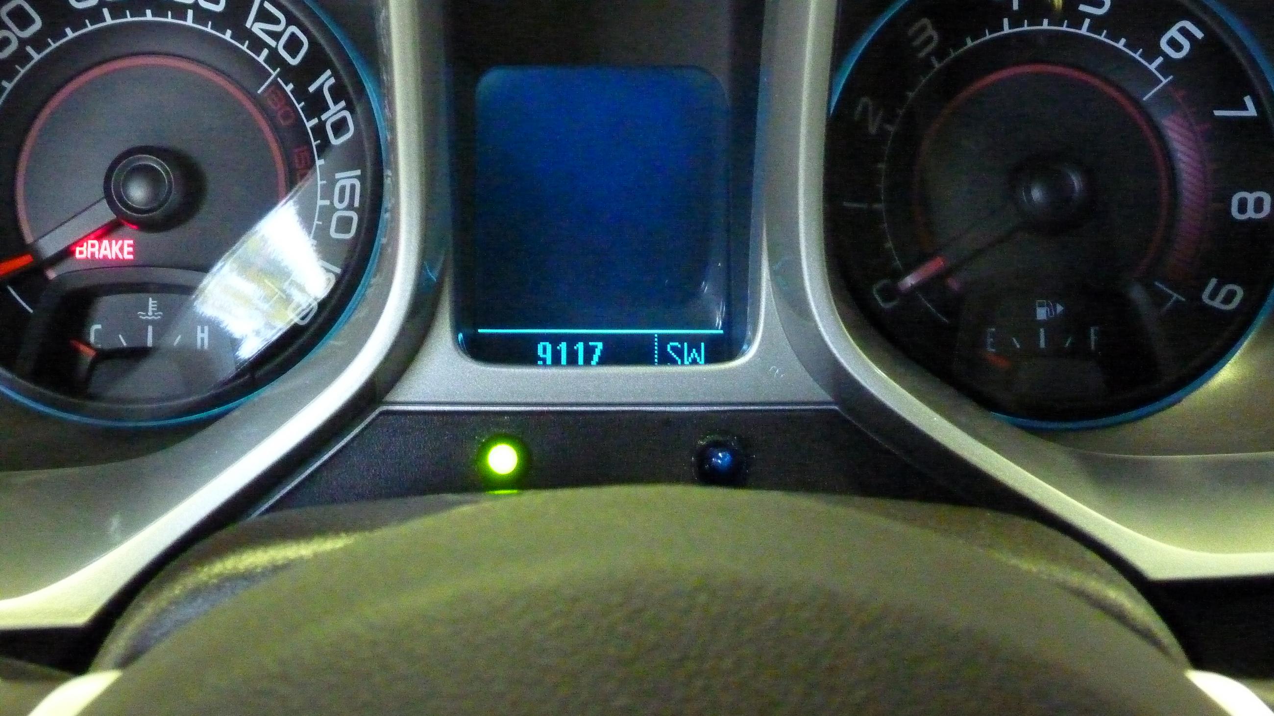

Step 6 Install the status light for the system. I chose to put it under the information center in the gauge cluster.

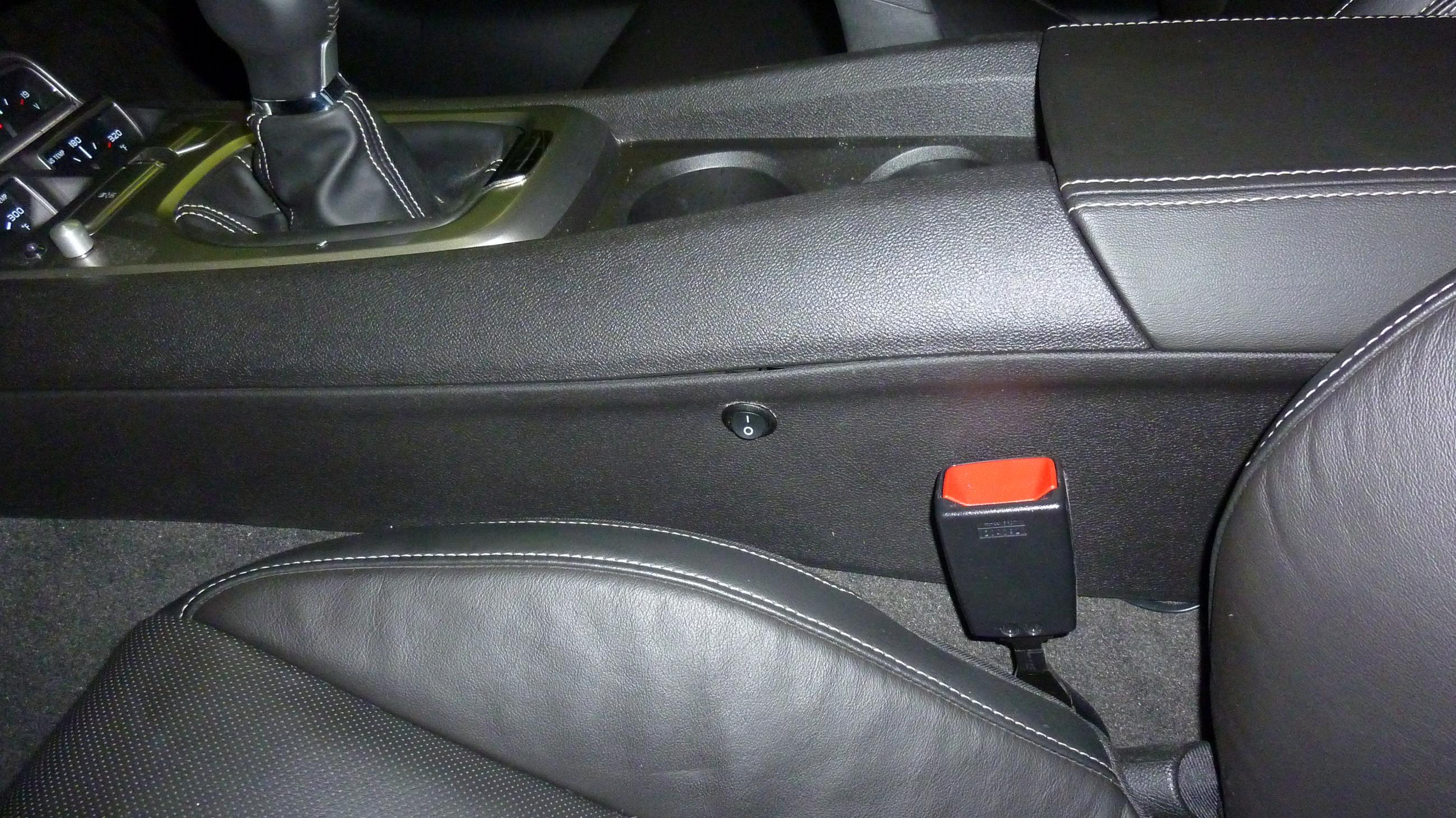

Step 7 Install the kill switch. It is a regular switch that i keep in the on position all the time until getting lasered when you slow down and then turn the system off. That is what the instructions suggest you do to avoid complications with the police.

No offense, but it looks like whoever did the install seriously thrashed your OEM grille. Even the hole drilled in your center console looks pretty hastily done.
