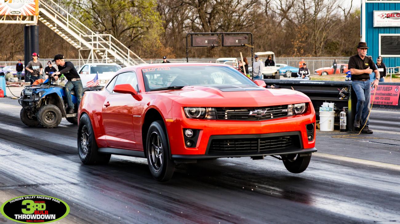

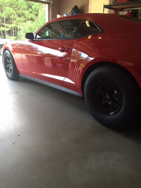

I am just finishing up my 15" wheel conversion on my 2013 ZL1.
Carlyle Racing 15" Conversion (Lower Control Arms, Trailing Arms, Drilled and Slotted Rear Rotors, Carlyle Racing Rear Calipers, BMR Xtreme Rear Sway Bar)
Also did the Carlyle Racing Billet Lug Nuts and Front Wheel Install Kit, Hubcentric Rings, Camber and Toe Adjuster Bolts, Drilled and Slotted Front Rotors and Longer Rear Studs and 3mm Spacers.
This setup is replacing my 20" Mickey Thompson Et Street S/S and 20" OEM Wheels. I Cut 1.5x 60 Foots but Broke the Inboard Driver Side CV.
Wheels and Tires:
Weld Racing 15x10 S71B Rears with Single Bead Lock
Weld Racing 17x4.5 Alumastar 1 Piece Fronts in Black
Mickey Thompson 325/50/15 ET Street R's
M and H 4.5/28R17 Radial Front Runners
I had to Trim the Rear Inner Fender Liners and Grind a Little Off of the Brake Line Bolt Locations on the Upper Control Arms.
I am just waiting on a $2 valve stem which weld forgot to ship and I will post pictures of the car.
Setup keeps full use of the MR Shocks and still has the Parking/Emergency Brake. Also tires are all 28" tall and should not throw ABS codes.

I was torn between the 5 Spoke (Alumstar and S71B) or the Multi Spoke (V Series and Vektor). This thing has a nasty (means business) stance just sitting in the garage!

Updated with pics of the car.
Still waiting on center caps for the rears and it needs an alignment in the rear.
Front rotors should arrive any day now.
