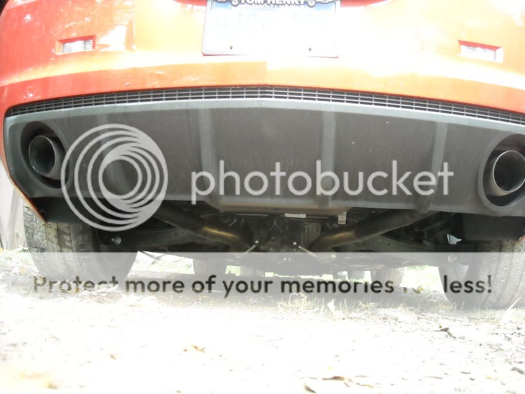

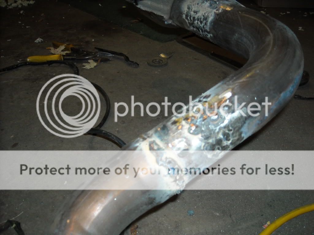

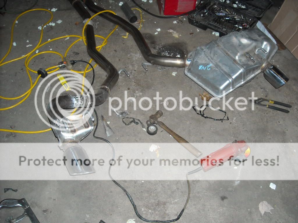

Hey, tried something I dont think anyone's tried yet, and it worked out great. I wanted to do a muffler delete but have no money, so i just cut the muffler up and used the existing piping in it, only cost me welding wire and torch gas. Took about 5 hours of work total and less then an hour to swap catback's. Used a torch to cut the muffler away, a grinder to smooth edges and cut away excess, and a mig welder to weld up the perforated holes in the pipe, just used the existing mounts. Forgot to get pics of it finished, used rust resistant black paint to cover where all work was done, also helps hide the exhaust under the car. Works great and sounds great. I can post a video too but it sounds just like every other muffler delete, No poping, but a slight gurgling sound on decel. Definately a project though, if you have the money to have a shop just put in a pipe it would be cleaner and easier. but it was a fun and cheap project with great results

Forgot to mention this is on the LS3, the L99 mufflers are different i believe

I would fall asleep welding each hole shut! LOL Kudos.

Also I bought a second stock exhaust to do this because I wanted to keep my original. So Its not like I've ruined anything if i decided to change my mind. I dont think anyone has done this yet, thats why I thought it was neat, just being resourceful.

It's also nice to see what the inside of the mufflers look like.
