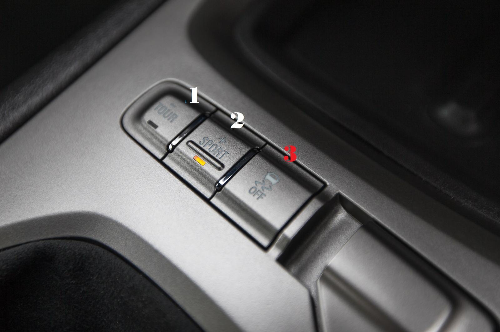

Everyone writes and perceives different so internet help can be a mess sometimes. Picture added to help visualize...
Disable all: Press & HOLD button TSC/ST (3), for ~7 sec. Light indicator on dash will illuminate once successful. Press TSC (3) again, to reactivate.
- If TSC (3), is pressed once, traction control is disabled. Light on dash will indicate. With traction controlled disabled, if the TSC (3) button is pressed again, PTM modes become available, indictated by another dash light, and traction control will be appropriate for which PTM mode is being used. Use TOUR- (1) and Sport + (2), to toggle between PTM modes. *Pressing TSC (3) twice consecutively at the beginning will also get to the PTM modes. No need to wait.
As for the Tour (1) and Sport (2) Buttons on their own (not being used to select PTM), steering effort and feel changes in Tour... reduction of effort. Sport steering feels the same as a default setting when the car is initially started. I have not spent any extra time to tell if there are notable differences with vehicle behavior (throttle or TC/ST) outside of steering. Steering is probably it as I doubt any real need implement much with those two buttons.

Holy moly...hold the T/C button down for 7 sec. The other buttons are clearly marked Tour & Sport which only changes the steering effort in a Z/28.
