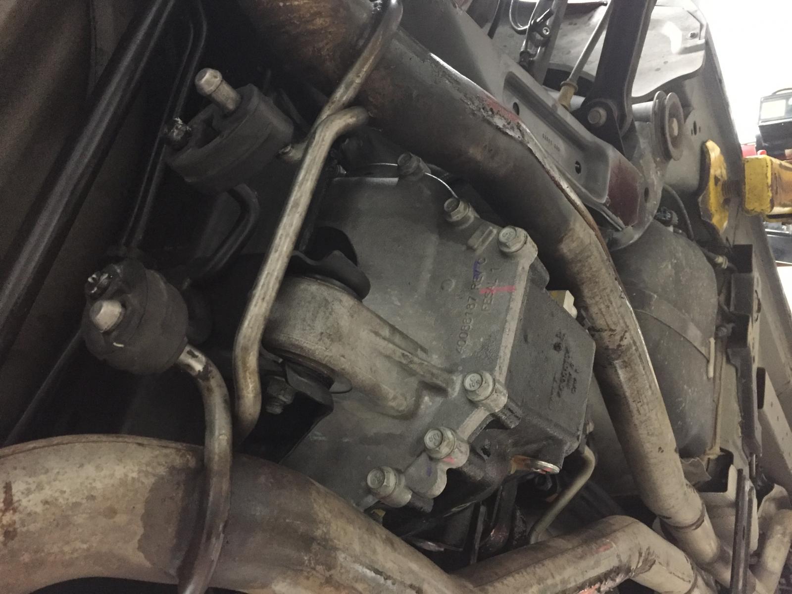

The way to measure a driveshaft correctly is to get EVERYTHING mounted in place, first. Then take your measurements. See pics below:
