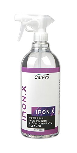

There are a few paint contamination removal products including chemical and mechanical.
For Chemical I like the results from Iron-X

YES!!!!
Clay towel and Iron X!!!!
