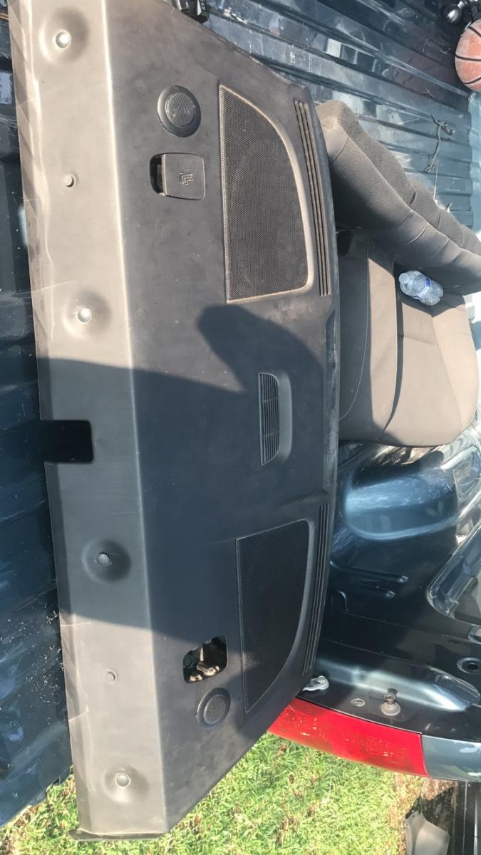

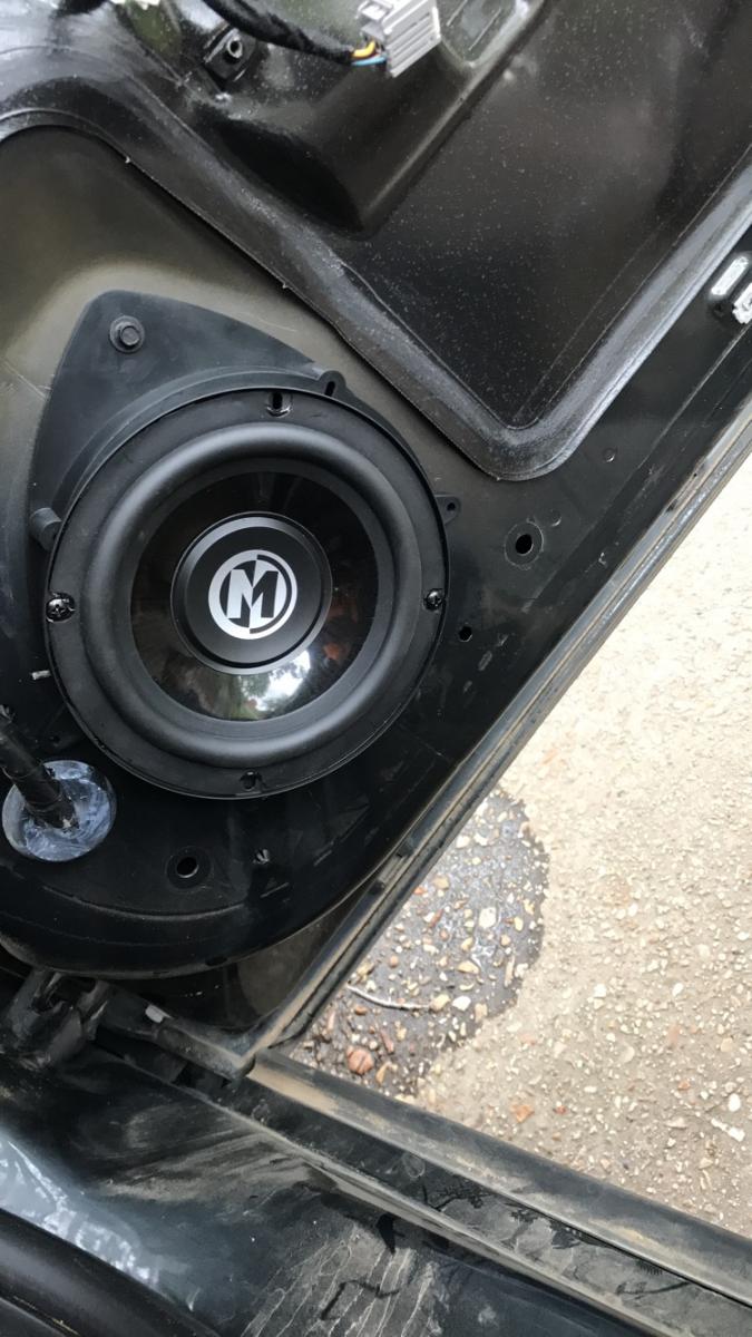

Took a whole day but finally did it, seat wasn't hard to take out the most trouble I had was putting back in the back dash, what you guys think? Added tweeters in the back and changed rears to 6 1/2" speakers new radio on the way can't wait to hear it

Nice clean job!

I just changed out mine too, if you didn't already, think about sound deadening those doors. Makes the mid bass better and is pretty easy to do. I bought 10sf of sound deadening and had left over. 70-80mil is best, cheapest I would use is noico, Fatmat or can go expensive. I used some noico in trunk area before and is good stuff, about $20 to get 10sf and is butyl, not the tar crap.

You can get an 11 sq ft roll of Soundskins for about $80. It is deadener and CCF all in one product.

Looks good. Did you make those adapters for the rear 6.5, or did you purchase them?
