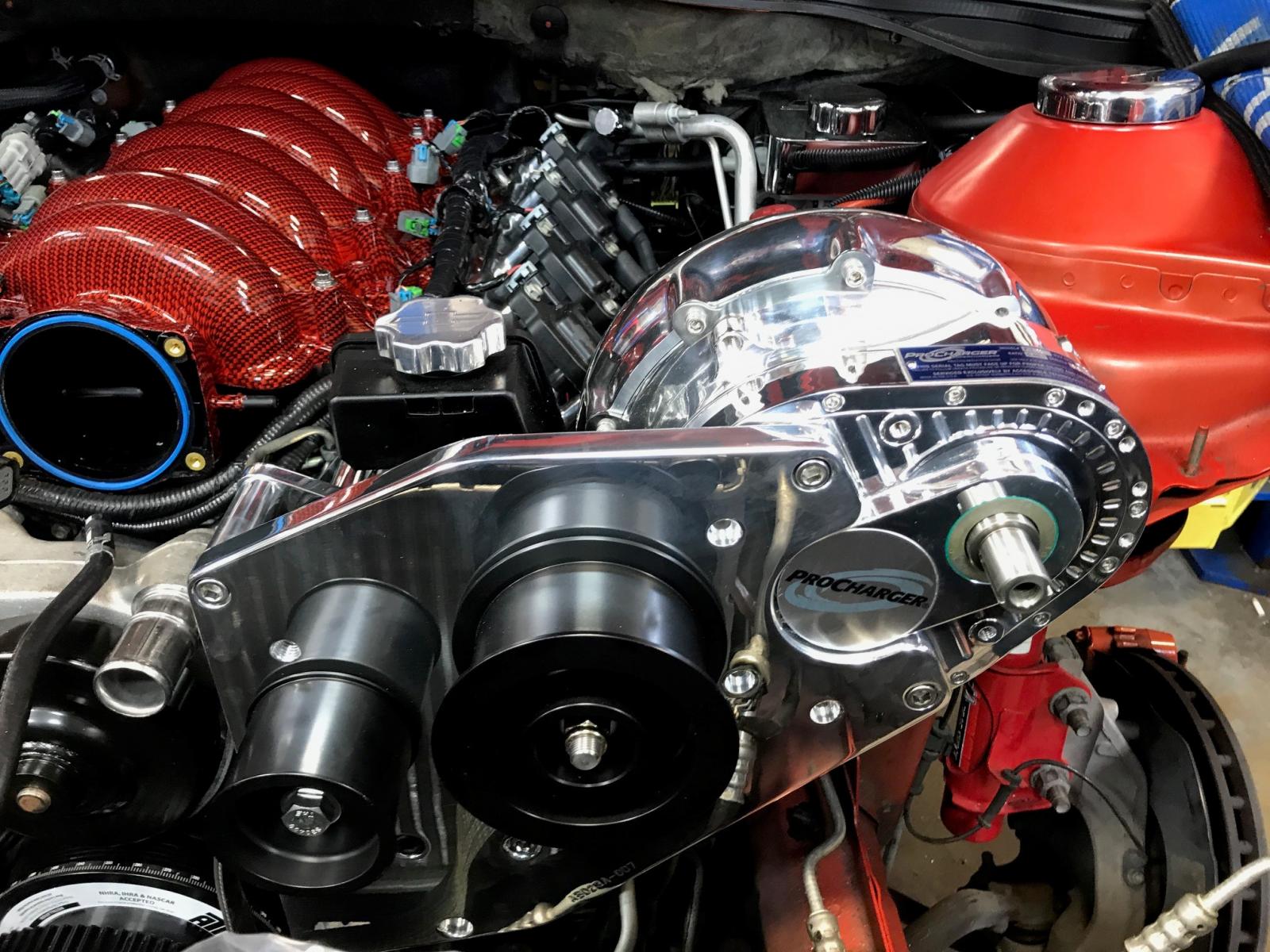

I suppose it has taken a while for me to state my overall goal with this change to the F-1X, but here it is . . . a street registered M6 that will break into the 9's. I am currently sitting at #5 on the "Anything Goes" street registered M6 Fastlist with a 10.54. Right now the #1 spot on the list is a 10.1 so I have a bit of work to do.
I did make one minor suspension change since that 10.54 I ran last December that I have not tested (Lakewood 90/10 front shocks), but with the F-1X if I can pick up a little MPH on the top end while still managing a 1.5-1.6 sec 60' then I may be able to improve my position on the list with this new setup. I don't think I will be able to break into the 9's without changing the block, but when and if that ever happens then I will be shooting for some crazy HP in the ~1200 range.

Here are some updated pictures of the build progress. Looks like they will probably finish it next week. Excited to get this done!!
