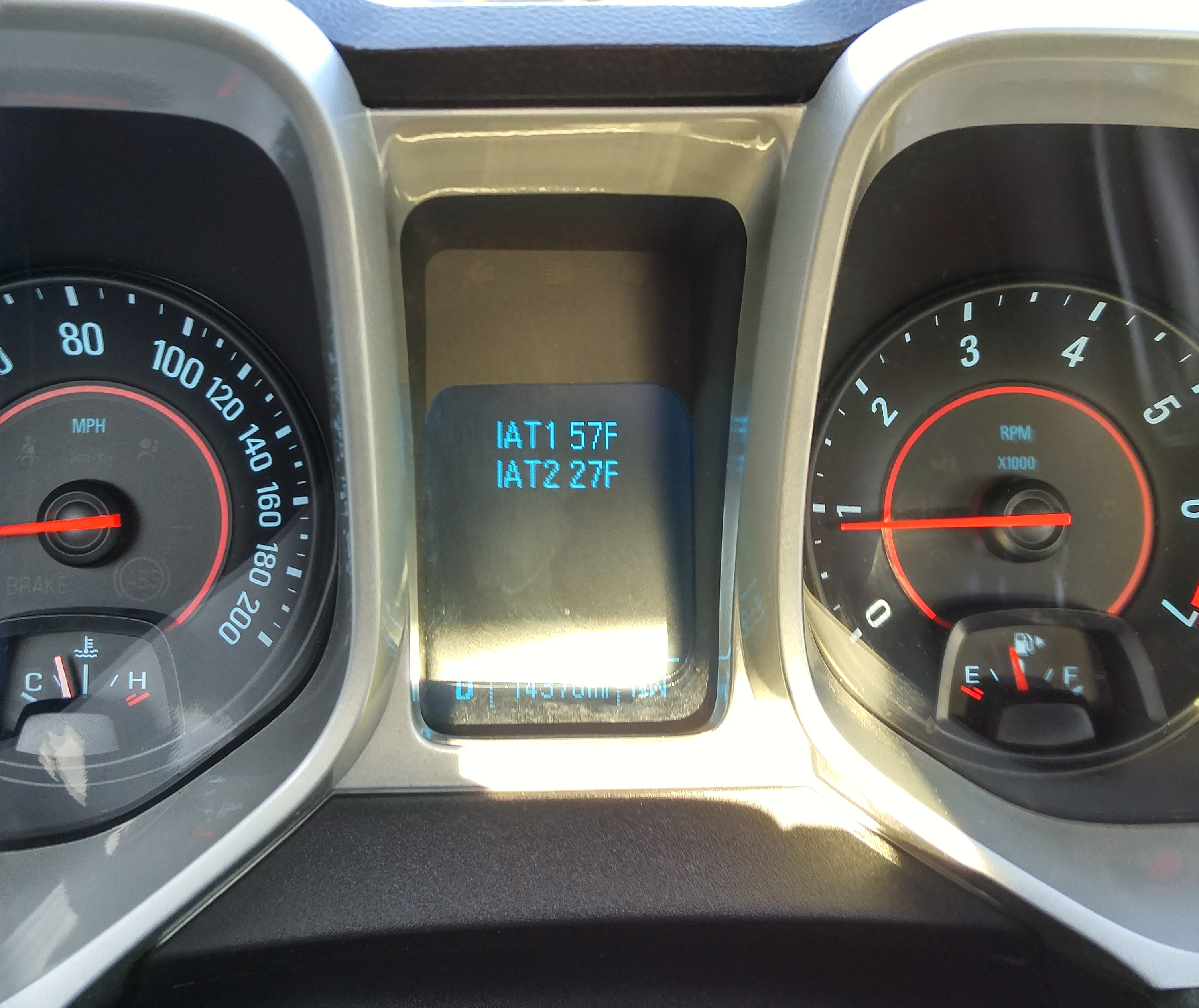

Depends on how cool you want to keep it. I'm running a Forced Induction interchiller on mine and the results speak for themselves.

How did you get that to come up on your screen like that 97Chameleon?
Dashlogic

During normal, non-boost driving IAT2 (manifold) is usually about 10° above IAT1 (MAF). Also, just noticed, we're practically neighbors! Who did your tune?
