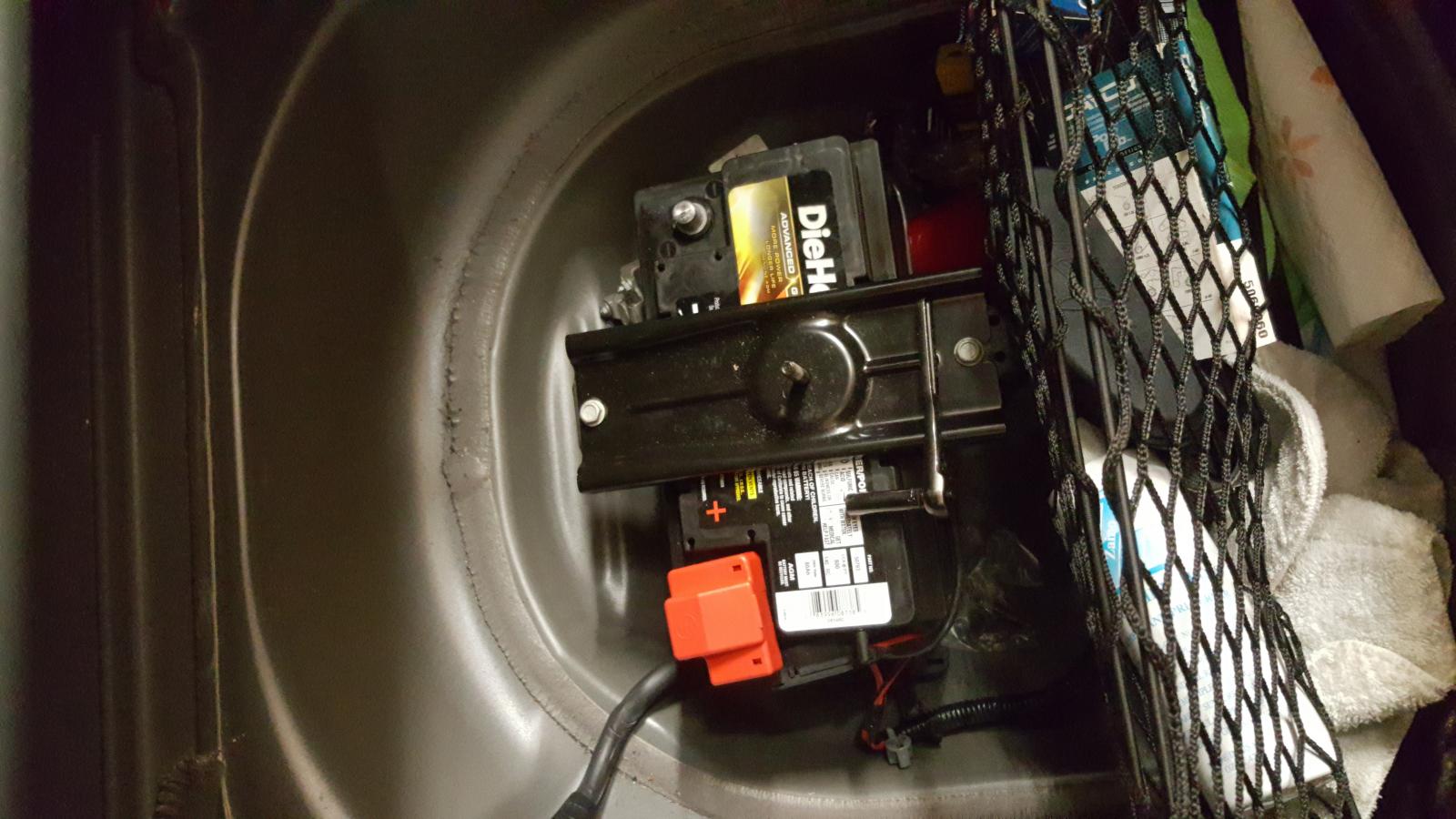

Step 1: Disconnect the battery

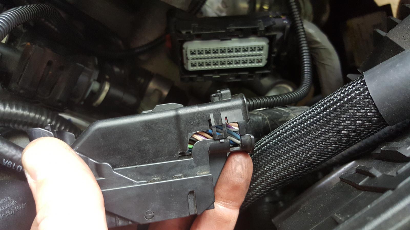

Step 3: Unplug the computer harness (one closest to the radiator). One is wrapped in grey electrical tape, one is wrapped in black, you want the one wrapped in black.
Step 4: Pop off the face of the harness using a small screwdriver
Step 5: Pop off the back side of the harness and cut the factory zip tie to separate the wires.

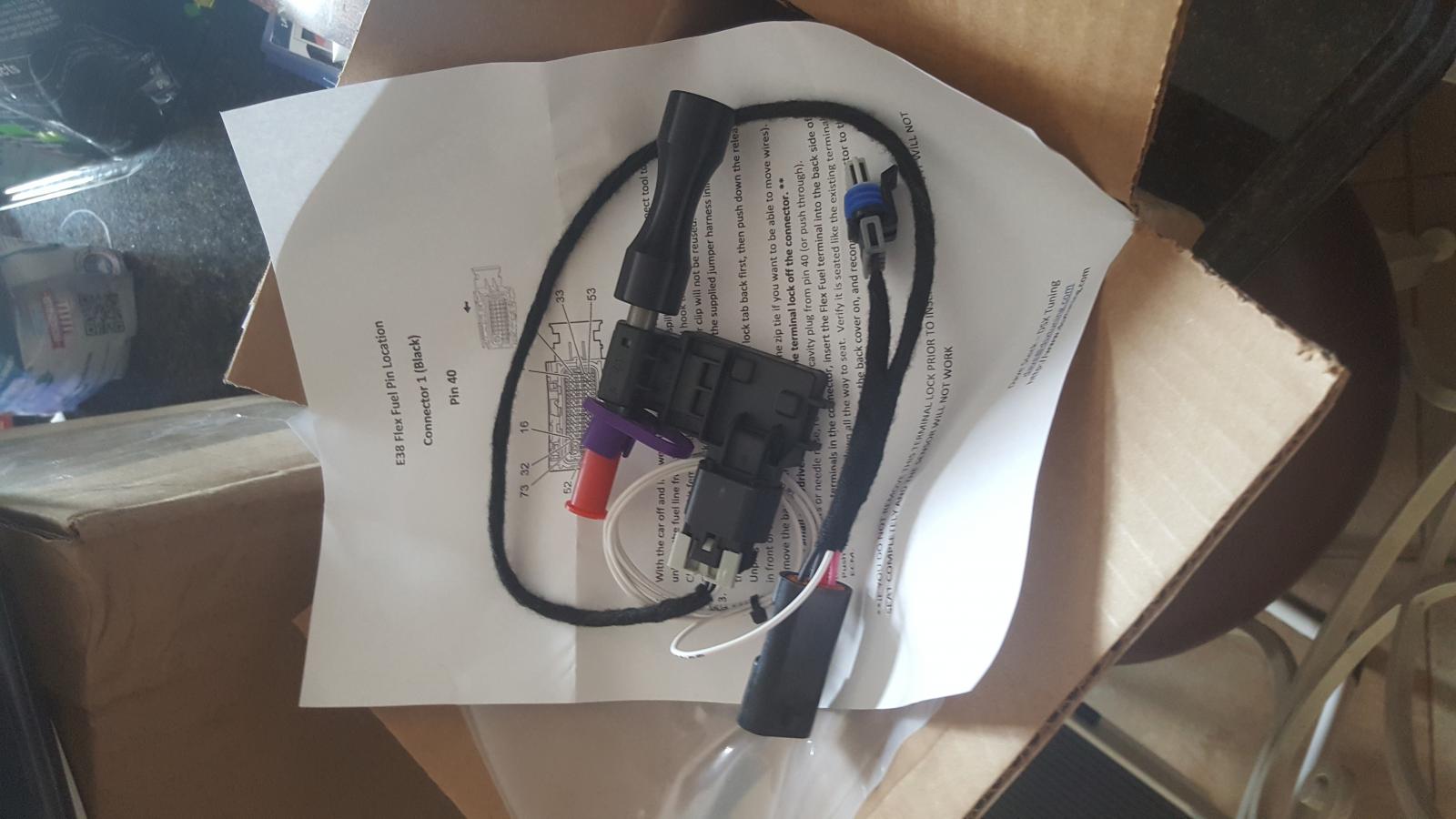

Step 6: Find pin 40, remove the factory hole cover, I just pushed it through using the small screwdriver. Then install the white wire from the DSX harness into pin 40 making sure the pin is clicked in.
