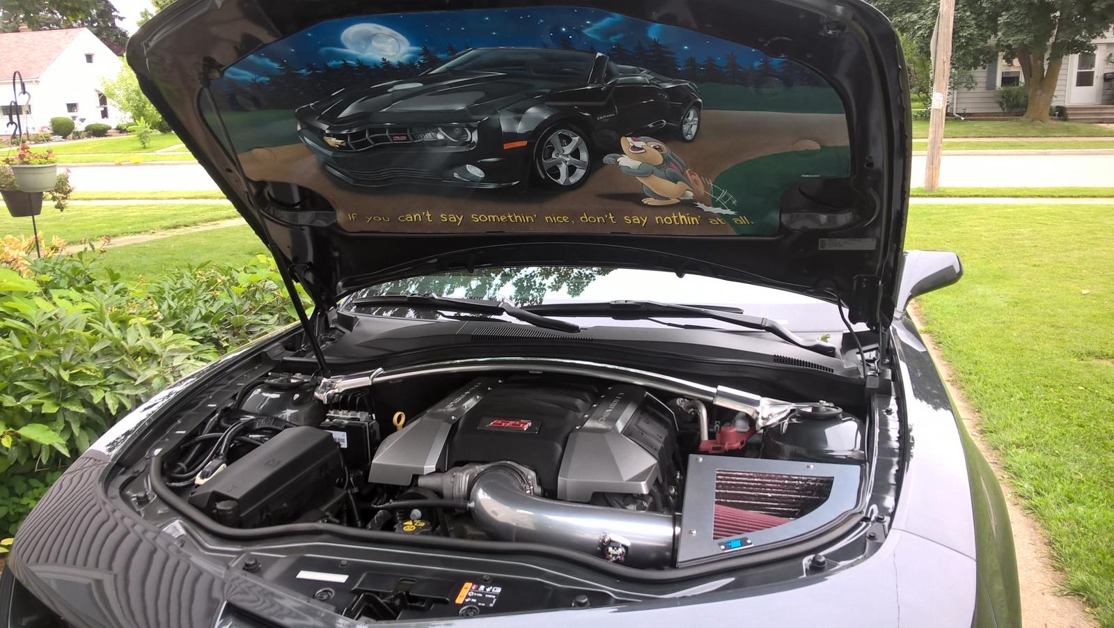

I went with the CAI unit because of the cover, insulated and doesn't depend on the hood to seal and keep the hot air out
