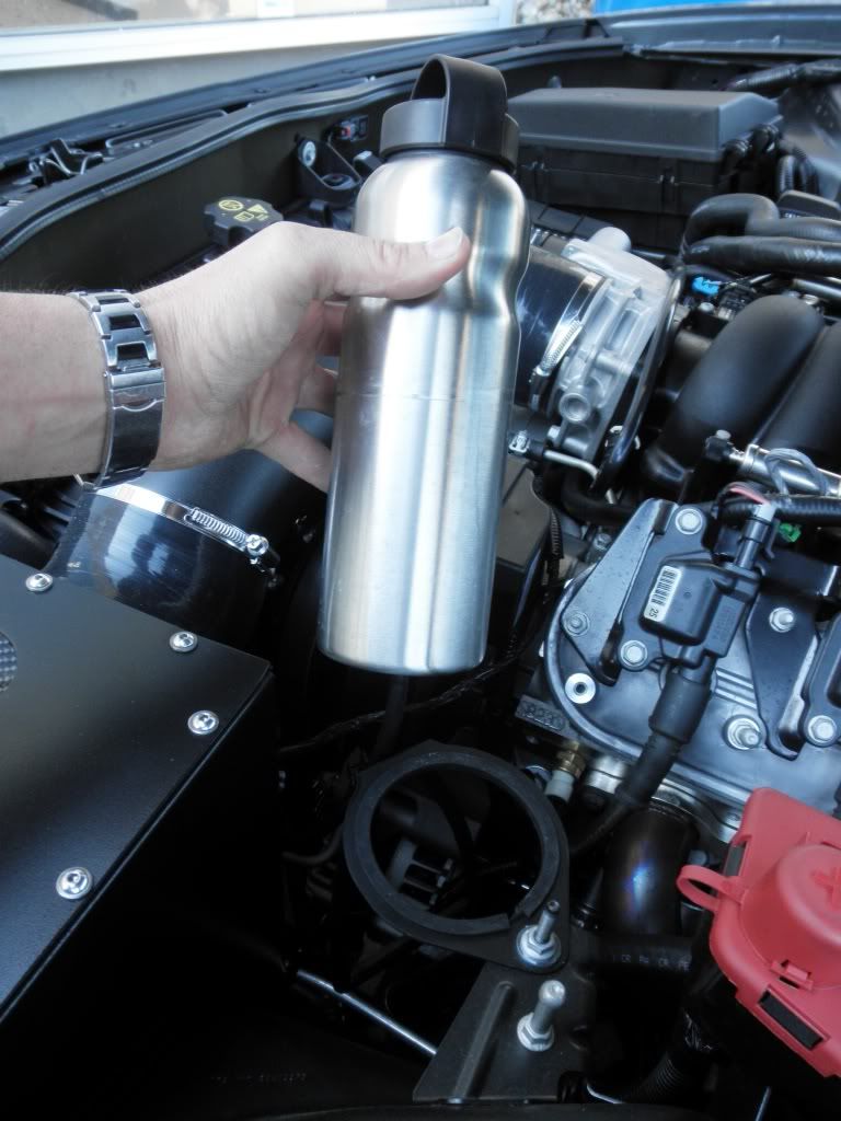

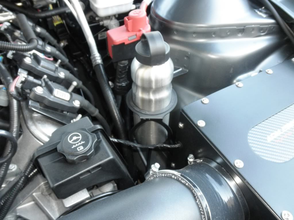

HOME SPUN WATER BOTTLE SOLUTION:
A customer and I have created our own solution using a 26oz. bottle that we made a bracket for. I too am the daily driver that wants to WEEKEND DRAG RACE. I have found that the 26oz. bottle we used provides for quite a bit of fluid for keeping the windshield clear. I found that I am washing this car much more often than any other car I have owned. These times provide the perfect time to refill the bottle !
