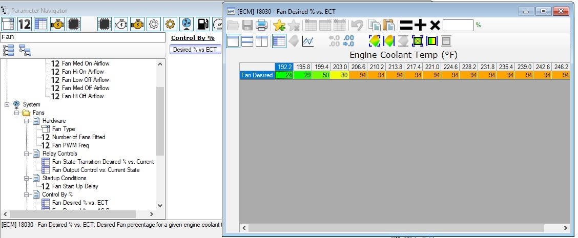

Also, if you can, modify the tune to have the fans start @ 192° (24%) and adjust from there. THAT does mean, you're warranty (if any is left) WILL BE VOID -- if you're out of warranty, then, that could also help you're cooling.

Here are my fan settings (from HP Tuners):
-Don
