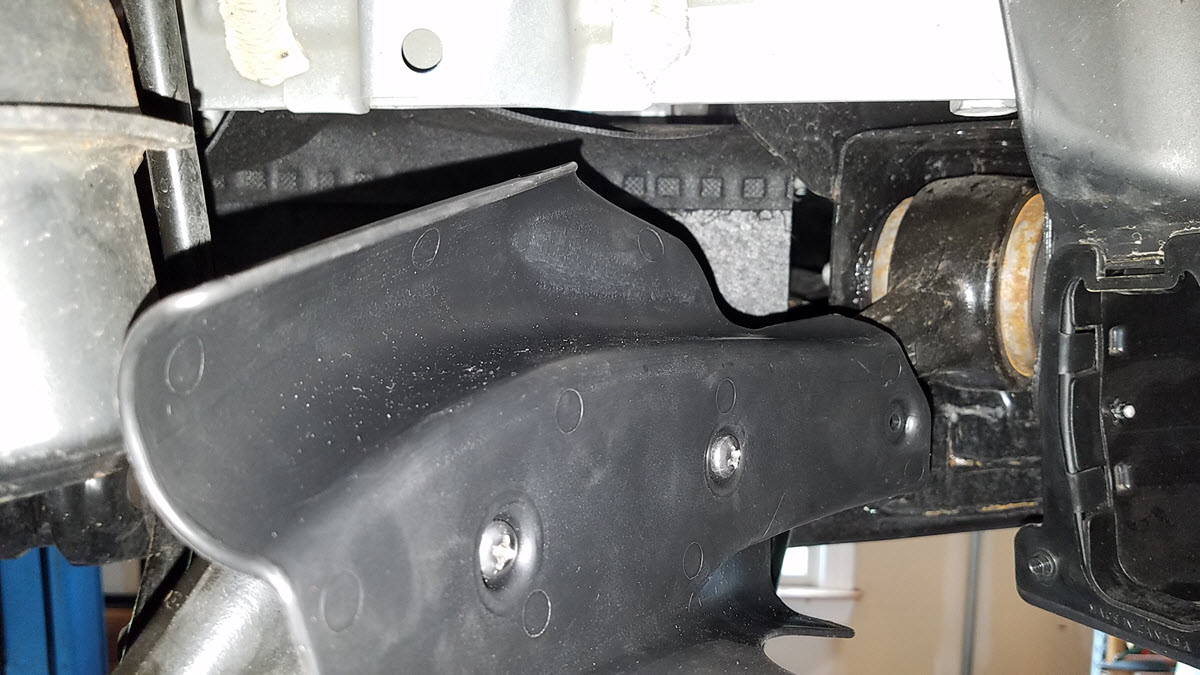

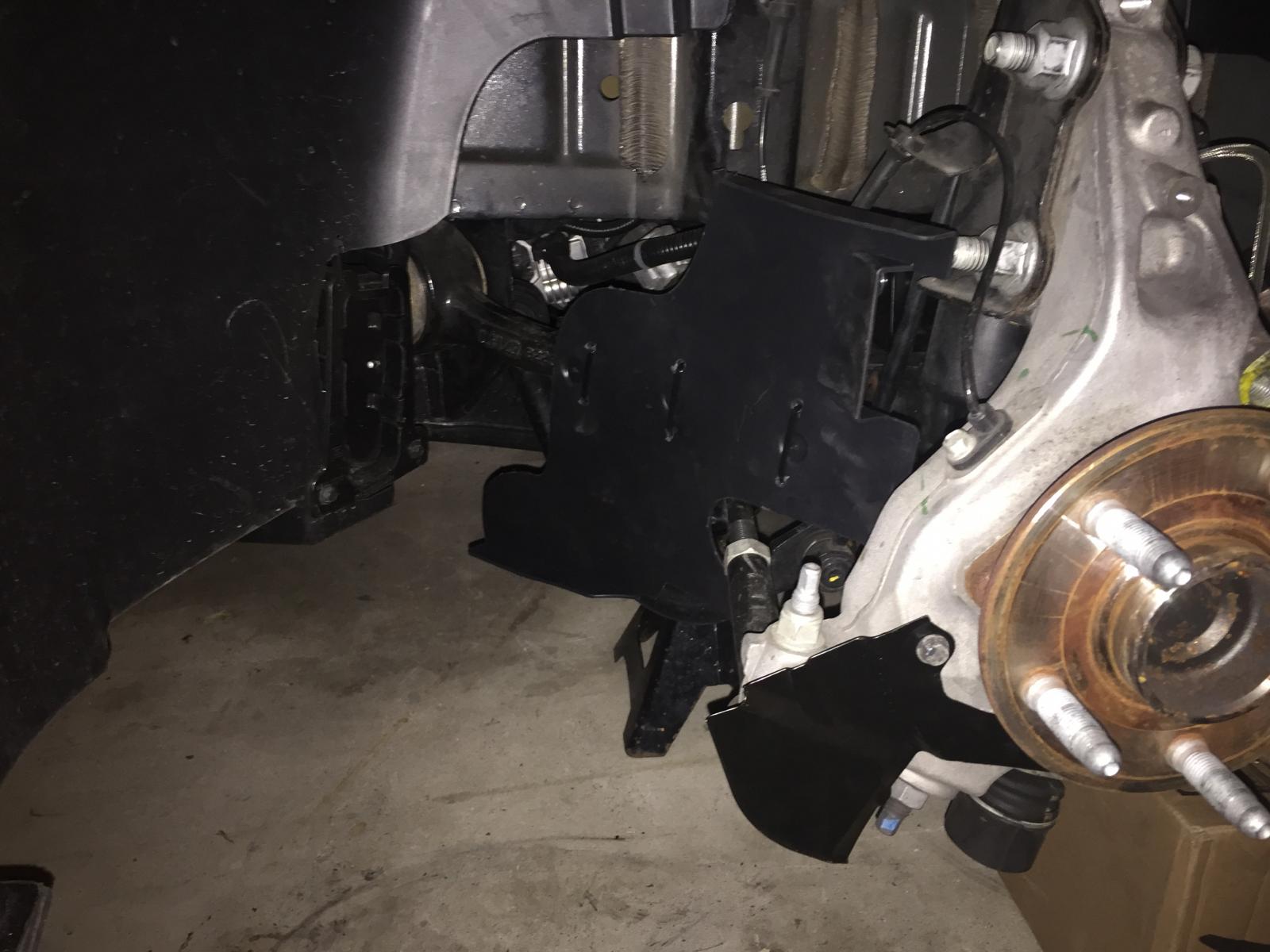

Hey guys, on my quest for more brake cooling I ended up installing the z/28 brake ducts and wheel liners using Nicks DIY as reference but then ended up ordering the 6th gen deflector and splash shield for $40 buks. Here are some pics and did 3 track days last week at two different tracks.... my CCMS didnt show a hint of fade. The splash shield alone is a big improvement and the deflector even more so just from numbers I have seen at work.
not a bad mod for $40 and took less than an hour to install. Of course I drilled holes into the deflector for zip ties since our links dont have the bolt holes. Anybody interested just PM on install.

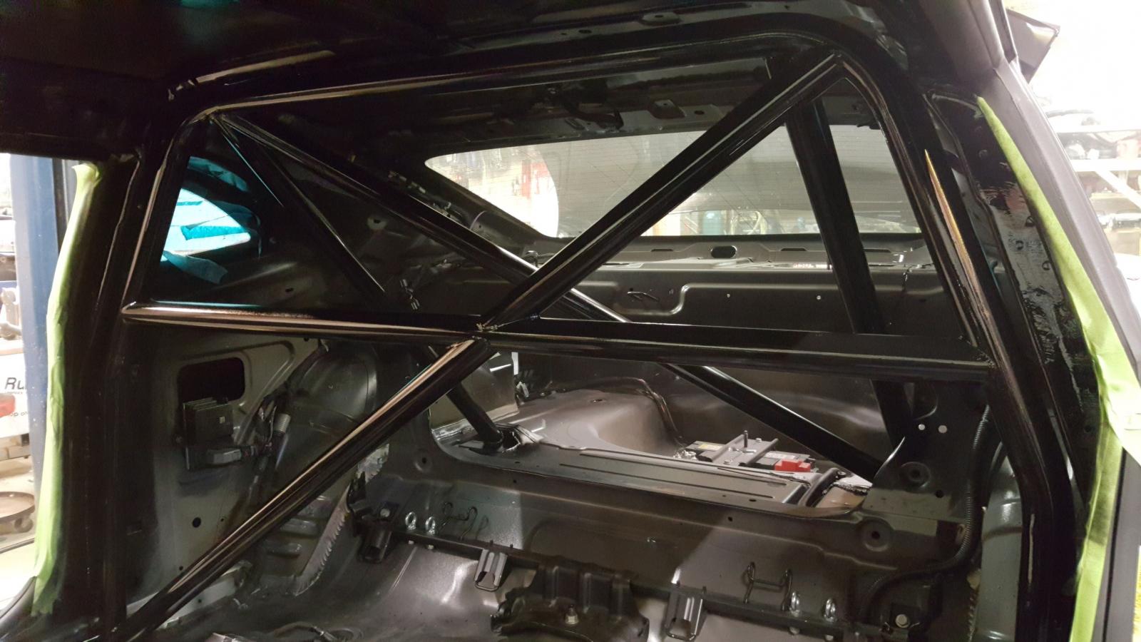

Oh and finallygot my roll hoop welded in!!! Big tx to a great new friend that custom made it for me. Welded to B pillars and less than 1/8" clearance to roof rail!! Rear points welded to shock inboard points. Love it!

Nice cheap mod to help open up more of the rotor area for cooling!
Wow you have gone full race car mode now with that cage! Looks nice. What is your car down to for weight without driver?

Were you able to measure the effectiveness of the deflector?
I've been contemplating a good method to take advantage of the z28 brake cooling ducts which I installed on my 5th gen '14 1le. The challenge is to route the air from the outlet to the back of the rotor, but the outlet is located at the pinch point of the tire/wheel meeting the chassis.
Instead of using the track deflector, I opted for the standard deflector that comes on the 6th gen.
I used a simple piece of aluminum square stock to mount the deflector and create space from the suspension to better position it at the outlet.
Here are some pictures.

I havent measured the deflectors effectiveness but in the SS the car comes stock with the deflector you installed but the kit I put in comes for it for use on track, hence big jump in cooling over stock. I didnt measure anything physically at track though. The track deflector picks air up from under car a bit and also gets a lot closer to rotor and duct just like what you drew with arrows. Gmpartsguy has the kit for $22 shipped now.
