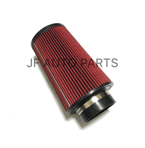

You will need an air filter for it. I got mine off fleabay for $15 shipped! Just type in (3.5" inlet 9.5" tall high performance cone air filter) and you will find it. Or you can get any filter with these dimensions and will work.

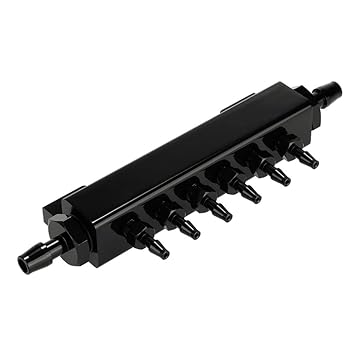

You will need a vacuum block for your BOV and Boost gauge. I got this off the bay for $15 shipped. Search (6port vacuum manifold)

Air inlet for procharger-$15
https://www.ebay.com/itm/3-5-inlet-9...53.m2749.l2649
