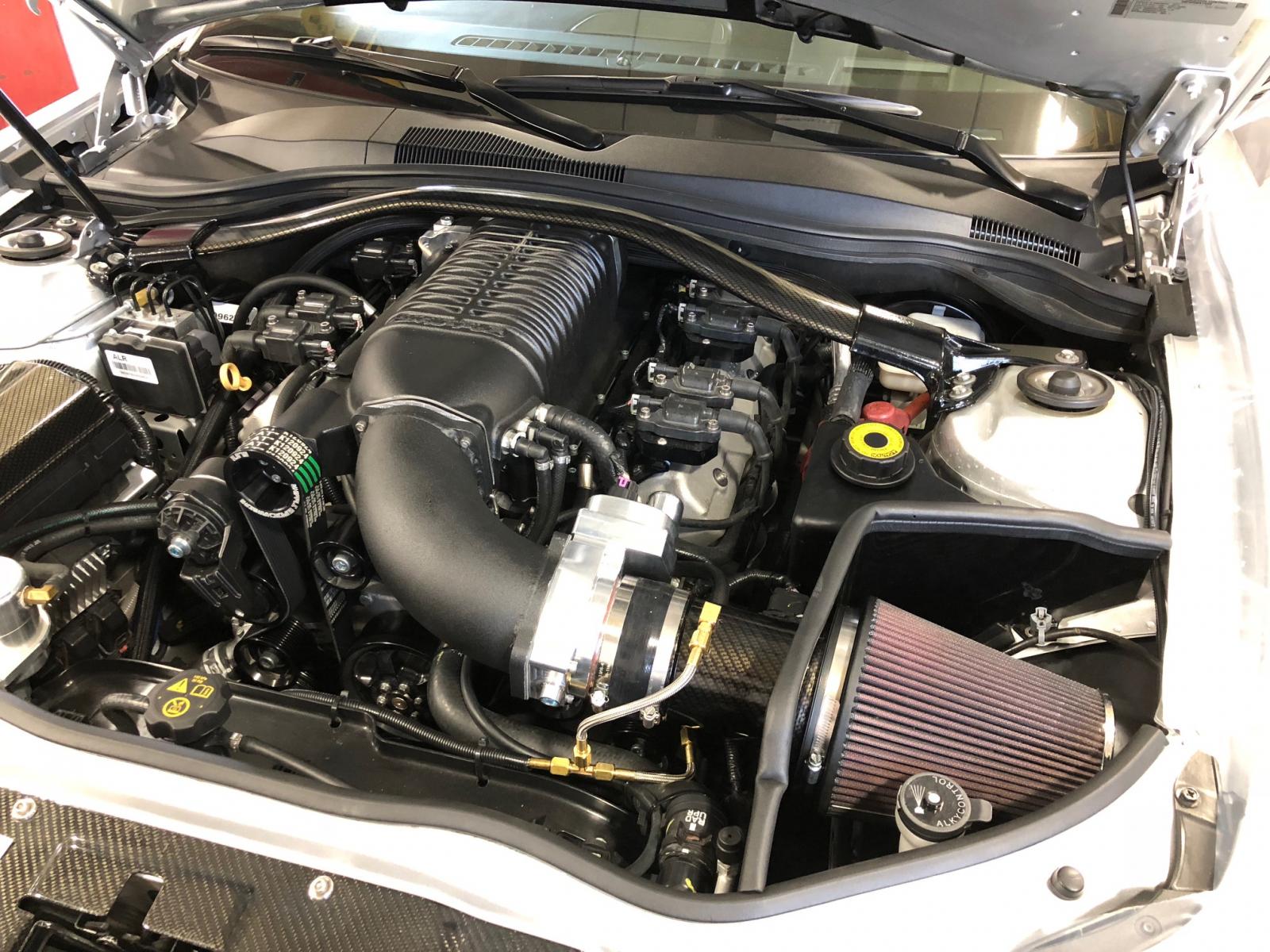

Here's a rare Z/28 I caught in the mountains late last year. Check out his blower. IMO if you wanted to go the blower route perhaps buying a cheaper LS3 2010+ would be an awesome option, not to mention having two different builds with using the same great chassis we have all come to know and love.
