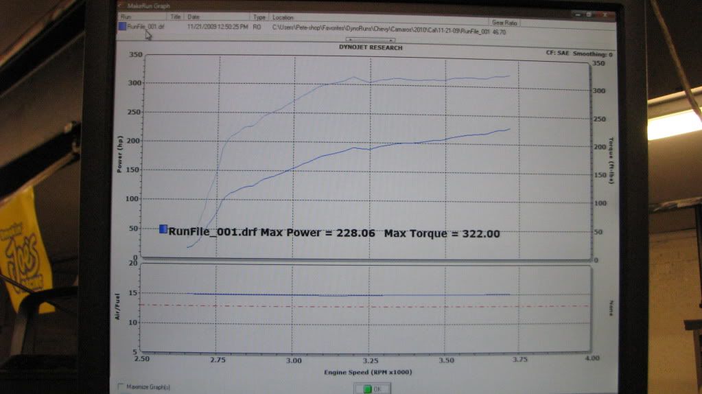

3 weeks ago my bone stock L99 had an air/fuel ratio that dipped into the low 10's on the first dyno run. After my brother did the tune, it pulled 330 hp, 343 tq SAE with a/f approx 12.5-ish. I installed a Roto-Fab cai yesterday and figured I'd be "a little lean" and would be a good idea to retune it. Got it back on the dyno today, pulled an a/f of 15 and aborted the first run. My brother retuned it to 12.8 a/f and pulled 340 hp, 350 tq SAE. HP/TQ increase was even from bottom end on up.
First pull after Roto-Fab install, check out the a/f:

Updated with dyno sheet above...
