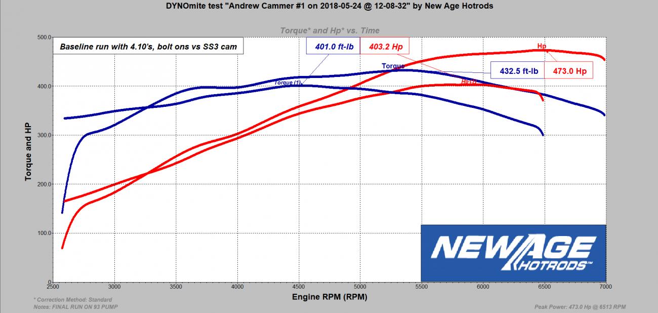

I hear you 100%. That's actually where this really shines, not only did it lay down a peak number, but it's a broad power and torque curve. It's ahead of the stock cam from 3250 on up in both HP and torque, and carries out well past the peak. I've had a couple laps on Watkins Glen with the cam, and several before, and I can tell you that, especially with 4.10s, I've always got a good gear for every corner, and the car has NO shortage of power, even in situations where I probably should have been a gear lower.
But don't take my word for it. Here is a before and after overlay, before with CAI/Headers/Exhaust, and after with the Cam, Under-drive, and modded intake manifold.
Also, here is the curve on the dynojet, where I stretch it all the way out to the limiter. Not much give up at all.
