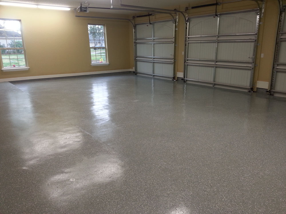

I had mine done 6 years ago, the garage/house was brand new, but as stated eairler, PREP is the key.
my builder uses Sherwin Williams and you can buy it as a DIY kit as well. each kits woll cover 500 sq. ft.
six years later I am totally satisfied with the floor.
Name:  PAINTED GARAGE FLOOR.jpg
Attachment 947772
That's exactly what my floor looks like too. I should have taken pictures of before and after. Home was only 8 years old but the previous owner had spilt everything under the sun onto the floor and cleaned up very little. Oil stains were plenty. Now super duper clean.

That pic was when its was BRAND NEW, so the finish is really glossy.....with all the foot traffic and what not its not shiny....but still looks great!
