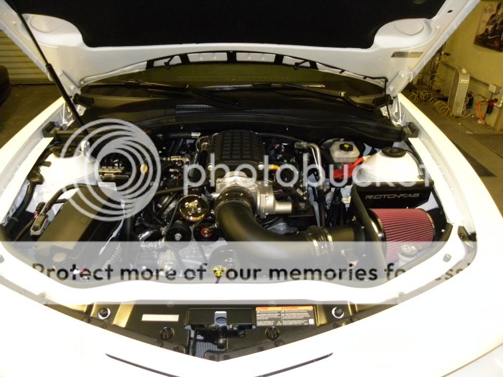

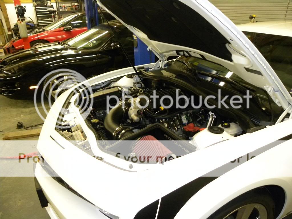

Another L99 over 500RWHP with no cam or heads!
We just finished up Jason's 2010 l99 auto car with out 600hp stage one kit.
Also he is getting some Pedders XA's and we installed a set of PFADT sway bars.

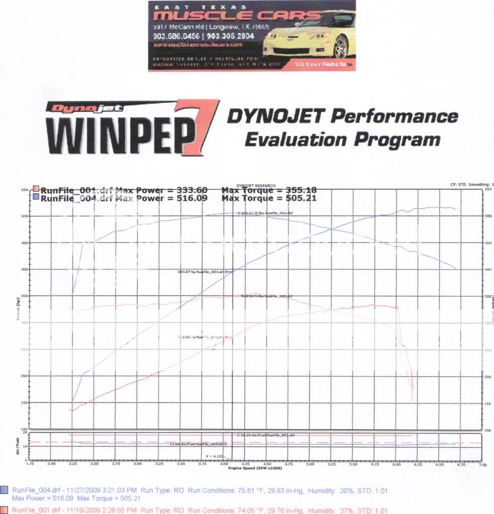

we will be making his vid in the next week or two, but till then here is a few pics and a dyno graph. the base line pull was 333.60HP 355.18TQ.
after the ETMC 600HP kit it did 516.09HP and 505.21 THATS 625+ at the crank without a CAM or heads!!!!!!!!!!!!!! He also wanted a really safe tune so if you look close you will see the FLAT AFR line is at 11.6 where we normally would run HIGH 11's to 12 AFR and could get a few more out of her easy!

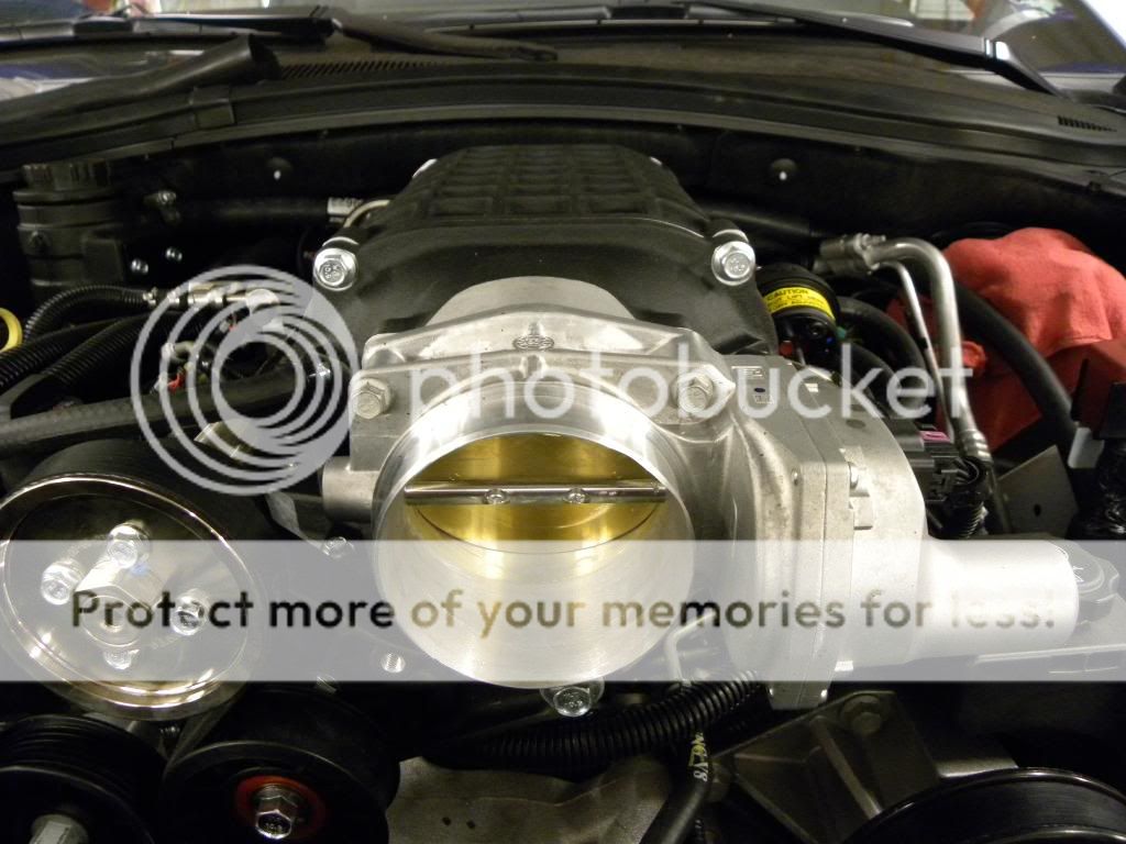

Kit includes
*ARH headers with High flow cats
*TVS 2300 wtih 8 psi
*new tr6 spark plugs
*ETMC tune
*ETMC ported TB
*Roto Fab CAI
*Magnaflow Axleback Exhaust
THE CAR
THE GOODIES

What are the SAE numbers?

SAE is 325 hp and 346 TQ BEFORE
AND---504HP and 492 TQ after
As you can tell same gains even in that correction factor.

Looks great! Are the sway bars going to help with wheel hop? also, what are you going to do with the stock engine cover? I've seen some where they've been cut and mounted somehow.

we have not yet tried to make one fit. The pass side would be easy to make fit, now the pass side would be a little work. As for the cover the customer took it with him.
