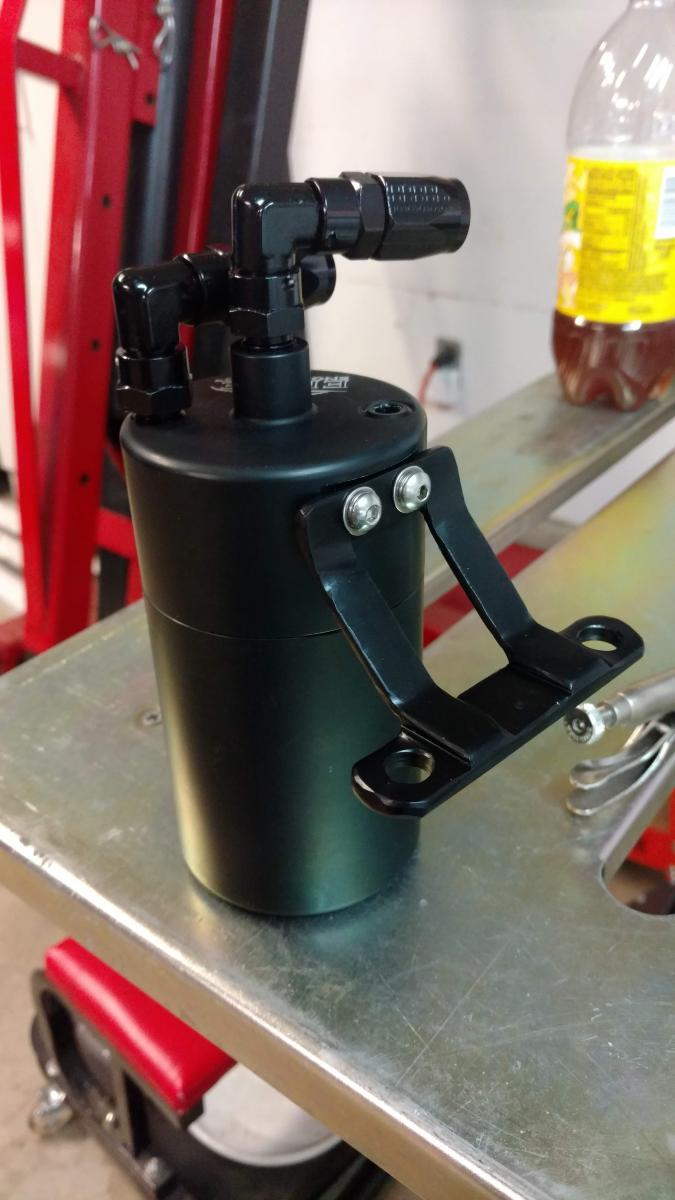

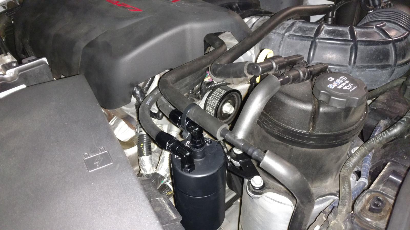

Not duals, but - a Z/28!
Got the catch can from Elite Engineering. Well made unit. Went with the single can, but as you might see, it's plumbed for a dual. Elite does not have a Z/28 specific bracket, so I put my crappy welding skills to use. After building my own bracket, which was fun and improved my crappy welding skills, I saw a link for all the Elite brackets. If you are thinking of mounting a can using the oil canister like I did, I'd recommend you check out the bracket for the Pontiac G8. Looks like it would do the trick.
