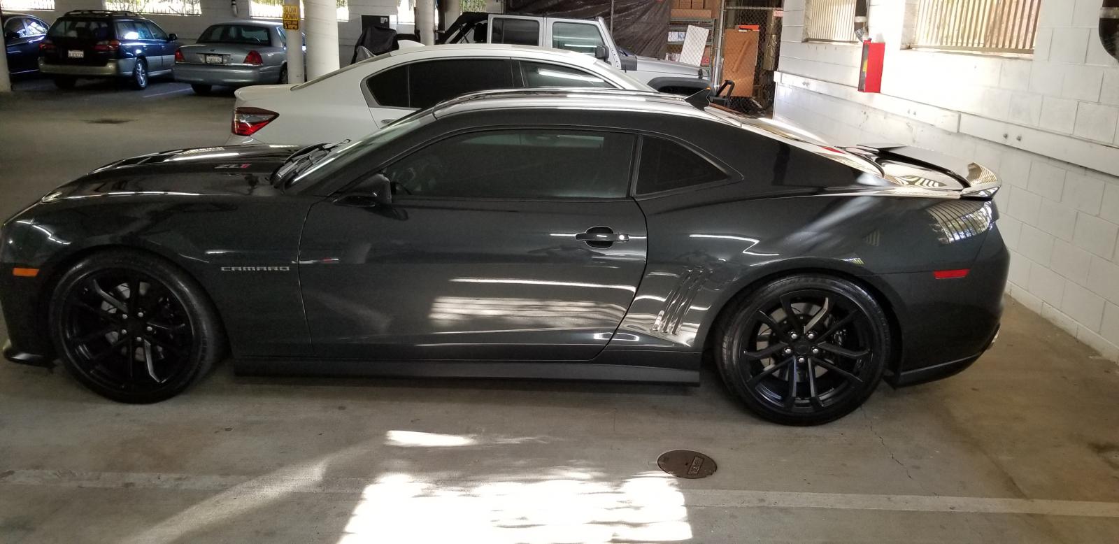

Old 11-08-2019, 03:52 PM   #5
1Willy1
Drives: corvette z06
Join Date: Feb 2018
Location: toronto
Posts: 97
would love to see some photos of lowered ZL1's on aftermarket springs
1Willy1 is offline   Reply With Quote

Posts: 248
Fast 850cc Injectors, ATI Balancer, 8.66 Lower Pulley, 2.55 Upper Pulley, Lingenfelter CAI, Kooks LT with cat delete pipes, Noweeds Exhaust Cutouts (extremely loud under full throttle), BTR Stage 3 Cam, BTR Platinum 660 Valve Spring Kit, TR7ix Iridium Spark Plugs, Lingenfelter Solid Isolator, 160 Degree Thermostat, Larger SC Coolant Reservoir with Hose Relocation Kit, BMR 1.25" Lowering Springs, MGW Short Throw Shifter, Racing Brake 2 piece rotors front and rear, Starkweather Performance Custom Dyno Tune on 91 Octane.
691.38 RWHP
630.35 RWTQ
GONMAD510 is offline   Reply With Quote
Old 11-08-2019, 04:07 PM   #7
GONMAD510
Drives: 2013 ZL1 M6
Join Date: Sep 2016
Location: CA Bay Area
Posts: 248
691.38 RWHP
630.35 RWTQ

I approve of your color choice !

Originally Posted by GONMAD510 View Post
As a person who always considers the background and lighting when taking pics, I love seeing this kind of pic. It demonstrates the moments before the pic was taken when the owner is so pleased with the visual appeal of the car that he has to stop and stare at it before walking away. I know that feeling. Truly a luxury to be appreciated.
That’s is a great looking car & stance
