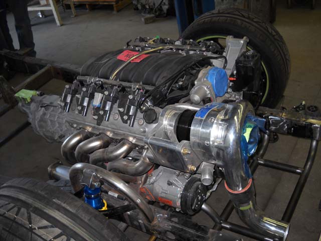

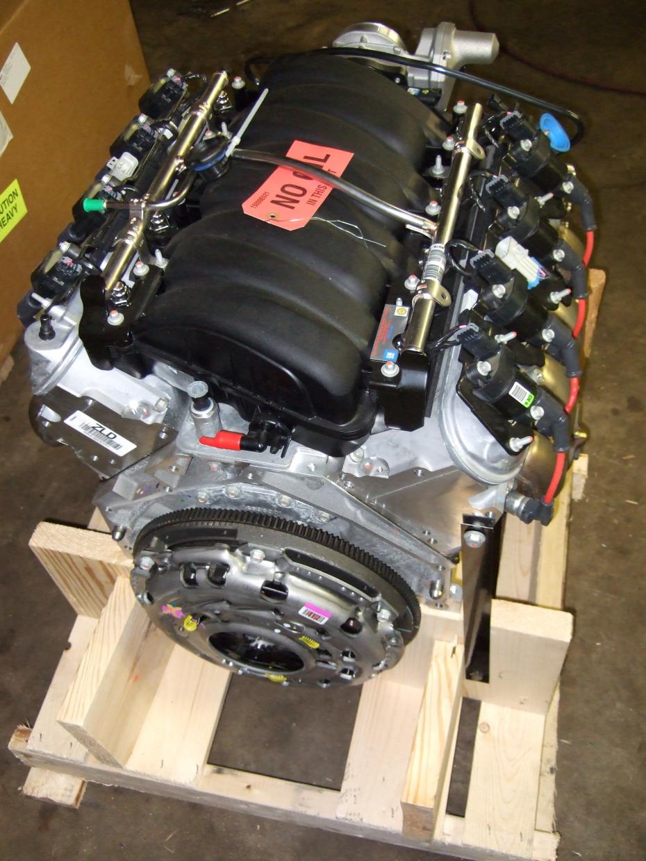

A stock 2007 Z71 regular cab short box Colorado was delivered to get the ball rolling as well as a LS7 crate motor and a T-56 six speed transmission. With this combo being stout to begin with, we knew we were going in the right direction…but once again ATI Pro Charger jump on board with one of their F1A’s to give this LS7 some more horsepower…aprox 1100hp with 14lbs of boost.
As the truck was being torn apart we sent the motor to the guys at EPP to tear it apart and put some killer internals in to handle the extra boost.

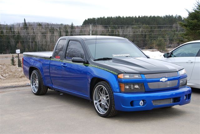

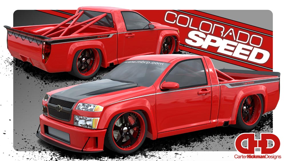

Here is the before picture, and then what it's going to look like when completed...

Here is the internals list...it was built to handle 22 lbs of boost...we are sticking with 14 lbs for now.
This is the list from EPP.
LS7 427 ci
Internal upgrades and custom cam from Exotic Performance Plus –
Diamond Pistons 11596
Compstar Connecting Rods
Clevite H series rod (CB663HN) and main bearing (CB2199HX) ARP main and head studs Total seal rings with an AP steel top ring
Comp Cam duration @ .050 is 236/246 on a 114 lobe separation
installed @ 113 intake centerline with .637/.650 lift Manley 5/16 one piece pushrods The heads were O-ringed at West Coast Cylinder Heads Valve springs are comp cams 26921kt
The engine is 428.69 CID. The bore is 4.130, and it has the stock LS-7 4" stroke crankshaft. The compression ratio is 9.37:1 The block was honed with a torque plate, and the crankshaft was computer balanced to
1/4 ounce/inch.

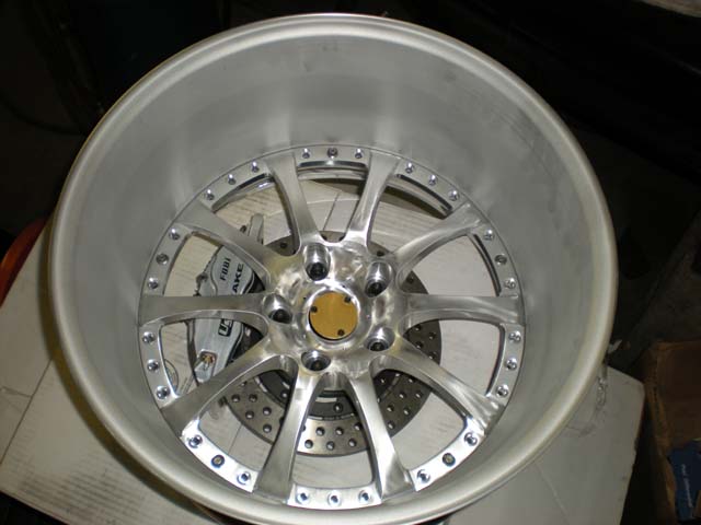

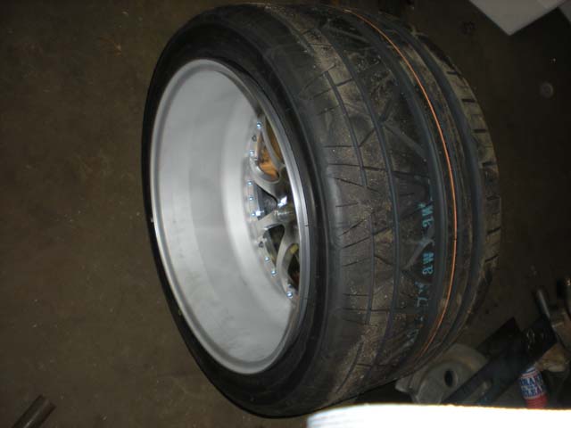

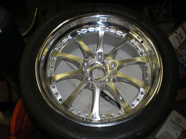

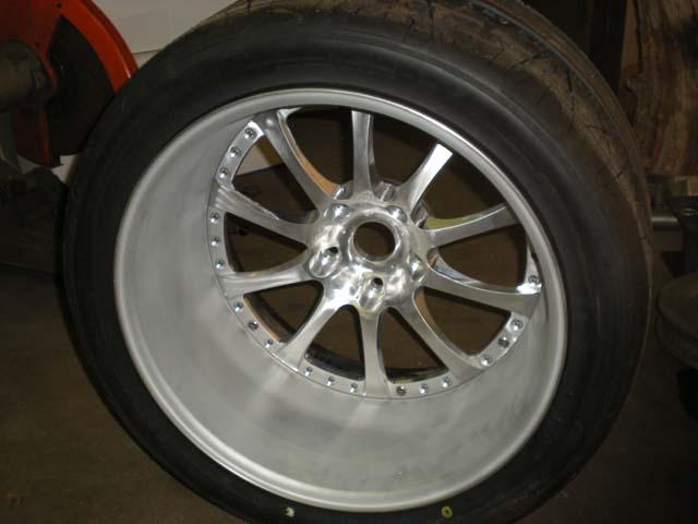

Forgeline hooked us up with a set of custom wheels...
Front -Forgeline ZX3r 19 x 9 - Rear - Forgeline ZX3R 19 x 12
Couple of shots with the raw finish while they were being test fitted.
In the pic you can see the US Brakes set up that we are running. The fronts are 4 piston with drilled rotors and the rear are 2 piston with drilled rotors. We are running a second set of 2 piston rear calipers with a hand E brake for drifting purposes...

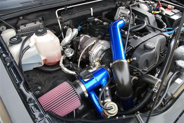

Sort of like this one we did awhile ago...
It was cool for sure, but completely different creatures...as you can imagine.

Hahn Racecraft builds one for the Colorado's...ours was used for the prototype.

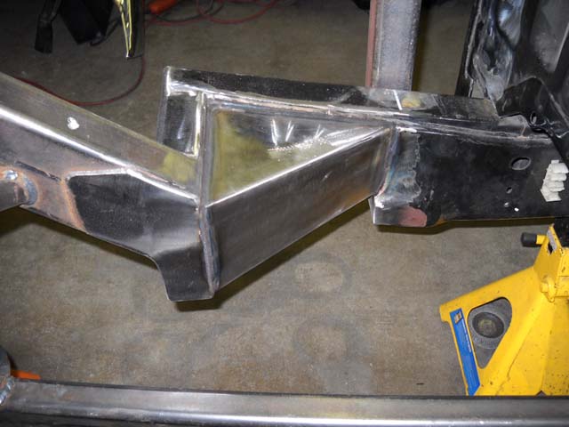

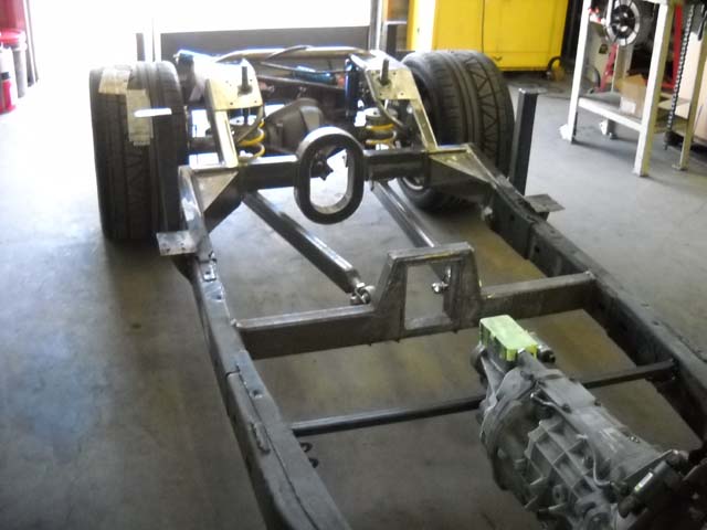

Here's the frame that Hitman Hotrods is modifying...
