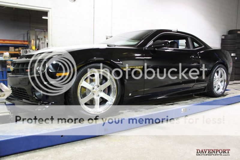

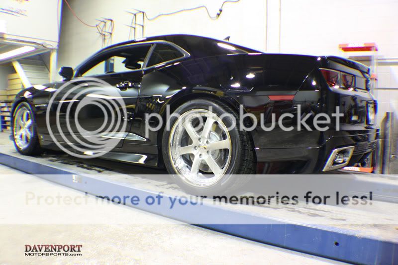

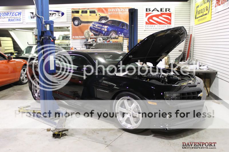

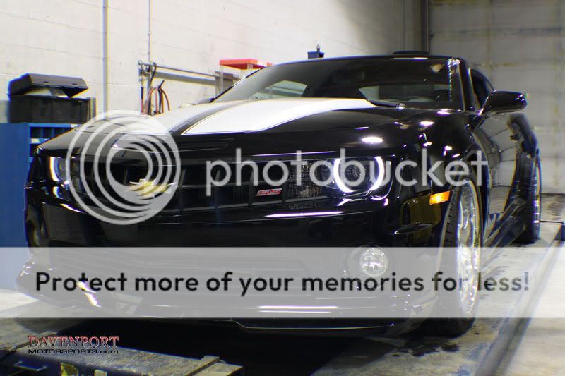

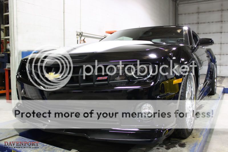

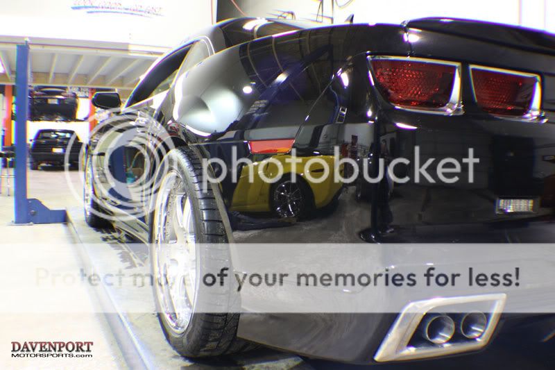

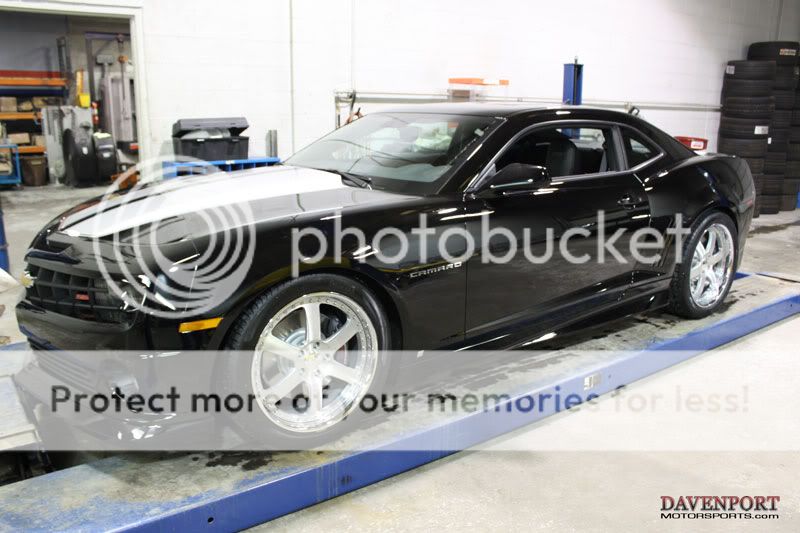

Here are some pictures of a customers car that we just finished. Boze Forged 3 piece "Shifter" wheels, 20" X 8.5" front, 20" X 10.5" rear, Pfadt lowering springs, and sway bars.
Oh, did I forgot to mention the TVS 2300 Supercharger, Stainless works long tube headers, high flow cats, cat back, ADM blower cam, and ADM cold air intake.
We were all amazed at how good the car looks with it's new lower stance and wheels. Everything fits great with no issues, working with quality manufacturers sure pays off!
More info on our other Camaro projects here.
http://www.camaro5.com/forums/showthread.php?t=54972
Hope to have some outdoor pic's tomorrow, will update if I do.

Very nice looking ride!

What size tires went on the bigger rims?

Good looking ride!

That looks nice!!!

I think it looks great!

I think those dual tips look sweet

We took the factory 275's off of the factory rear wheels, and put them on the front Boze's. Then got new 305/35/20 Pirelli's for the rear.
Thanks for all the kind words, we're really impressed with this set up.

One bad ass looking ride my friend!

Looks awesome I really like BOZE wheels alot. I spoke with them today on making us a set.
The only thing I would do different is the front offset so the wheel comes out further to the fender lip to match the rears. I rather have the wheel offset changed rather than using spacers.
Davenport do you know the offset they gave you front and rear?
Love them man. Also are these their 2 piece or 3 piece wheels? Zak at BOZE said they make 2 piece with a welded center and simulated fasteners around the face.
Judging by the widths he spec'd (8.5 and 10), that leads me to believe they are 2-piece construction. Great looking wheel choice for the 2010 Camaro, looks amazing!

That looks pretty bad ass!!

55designs,
Front offset is 28mm and rear is 38mm. Wheels are a 3 piece.
Nine Ball,
I incorrectly stated the wheel size, they're a 8.5 front and a 10.5 rear. They're a 3 piece as Boze only does the 10.5" in 3 piece, we thought about doing a 2 piece front, and a 3 piece rear, as the 8.5 can be made in 2 piece but, Zak told me that the 2 piece look slightly different, therefore front's and rears are 3 piece.
Sorry for the confusion, I should have been more clear in the original post. I've edited it with the correct information.
We're doing two more Camaro's with Boze wheels, I'll post pic's when we're done.
Thanks for looking.
