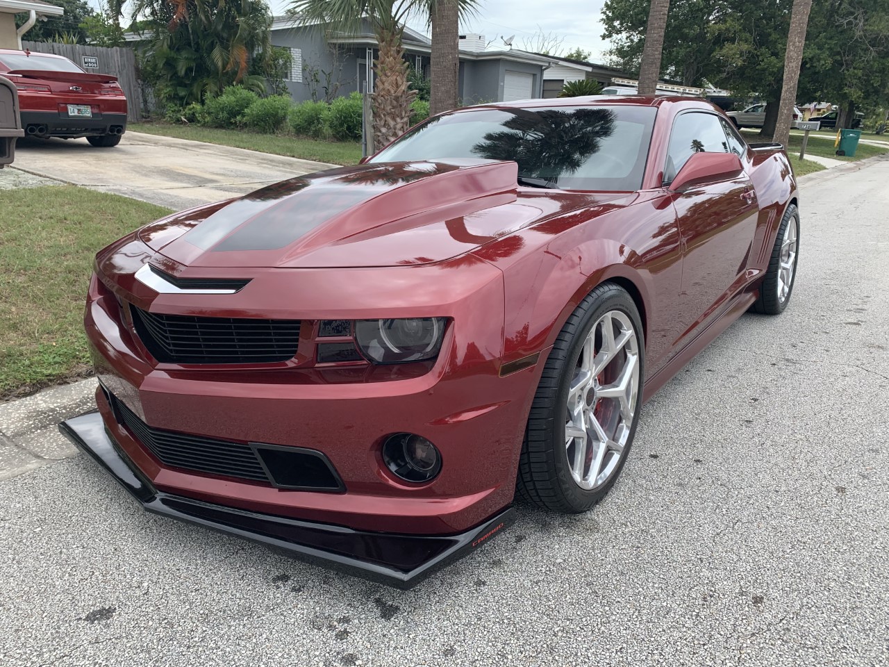

20x10 front,275/40 20x11 rear,335/30...

and if you really want to get aggressive,,, 20x10.5 front, 275/40 and 20x11.5 rear,335/30.
