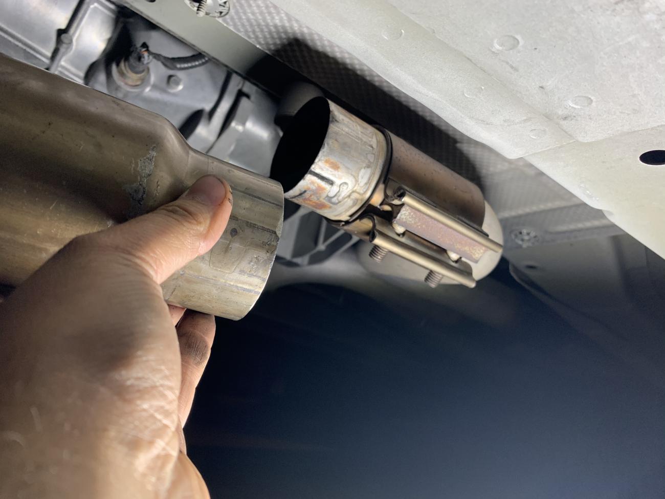

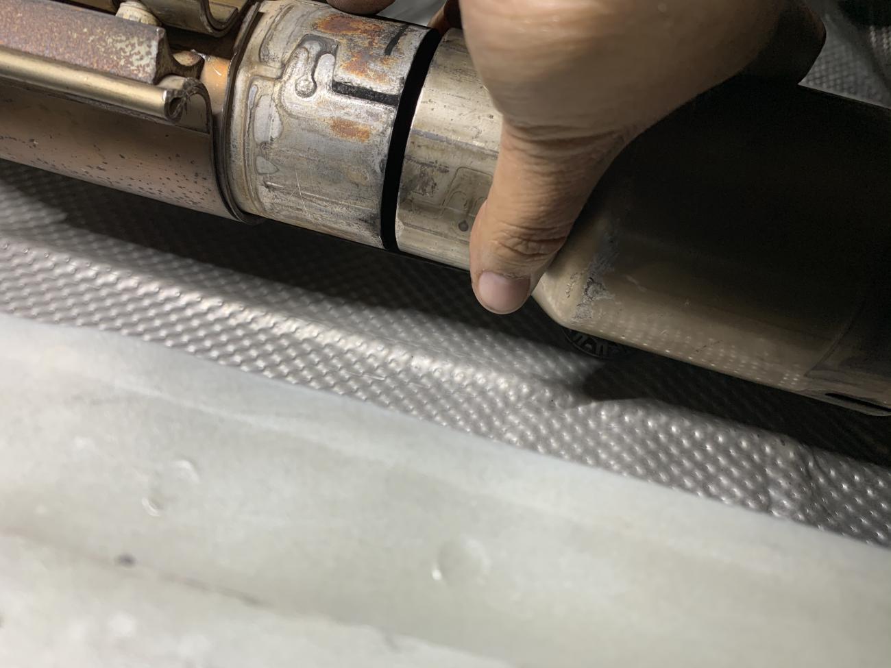

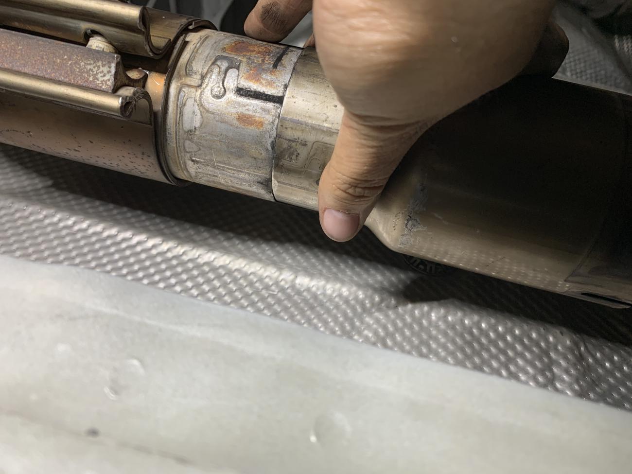

Does this look right?
I am installing my LTH and hi flo but the connecting pipe to my NPP seems wrong to me. I cannot fit the pipe inside or over the exhaust. Does it just but up to each other and the clamp holds them? No exhaust leak?

yup...just get it centered on the joint before tightening.

Yes that clamp should fit over both pipes and hold it together. That is how my exhaust was held together when I put on my exhaust. As far as leaks go I’m not 100% on reusing the clamps I’m not a mechanic or exhaust expert. But I reused mine and don’t notice any leaks from mine.

It should fit right in. Everything looks good to me.

it did in fact fit over both pipes and just clamp them together. Nothing goes in or over at the exhaust side, just the header to cat side
