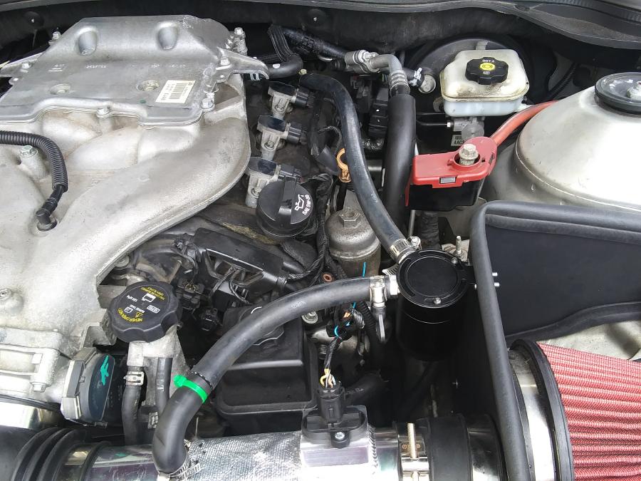

Mates Car.
2011 WM Caprice V6 (Commodore aust)
180000 Miles looked after.
Elite catch can/separator. Both instilled properly.
Any advice please.
Regards Pete.

There's always gonna be some oil, but the clean side separator gets rid of more of it. I'm thinking if you want to help it some more, you could add an Elite Engineering check valve after the catch can and before the intake manifold.

If it is al LLT or older motor, pull the PCV and drill out the bottom two holes to 5/64".
Drill the TOP hole to 7/64"
I had oil in my clean air side till I did that. GM updated the PCV part in late 2013, with
the bigger orifices. You can other buy the new part, or drill it out yourself.

You really don't need the Check Valve... If you put a breather on that back port,
where that originally ran to, then that oil cap catch won't see any real pressure
anyway.
You may also have a problem because you used rubber hose on the PCV side.
It will collapse eventually, and probably does under load. There is a reason the
factory is all hard-line. Mine, is hard line for the PCV:
Clean side:
$18.00 Catch Can:
Using them on both the PCV and CLEAN side.
