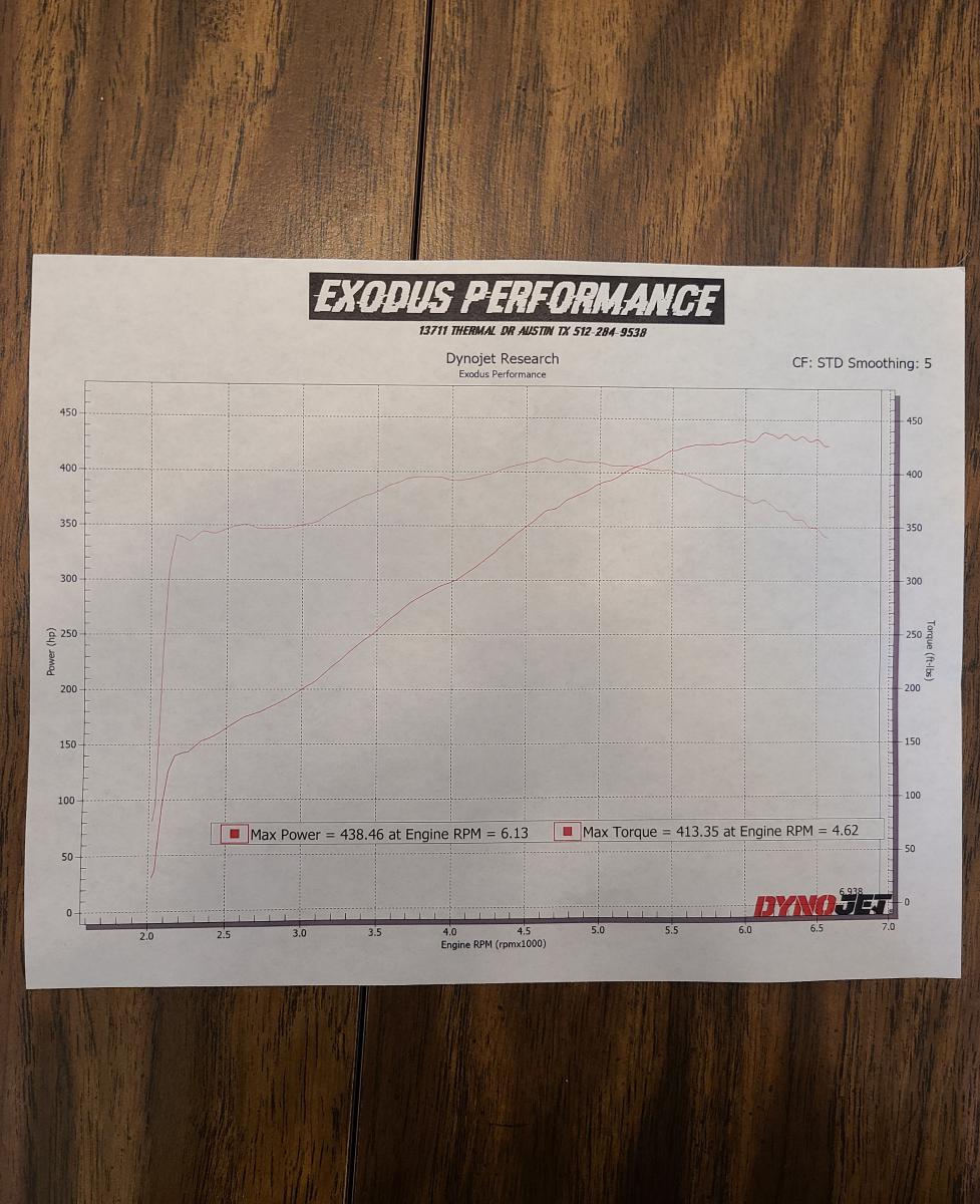

Old 07-22-2021, 09:05 AM   #13
morepowerjoe
morepowerjoe's Avatar
Drives: 2012 Chevrolet Camaro l99
Join Date: Aug 2020
Location: Austin, TX
Posts: 2,232
Here's my dyno chart. Let me know what you think. Thanks
DSS Pistons, Eagle ESP L19 Rods, ARP Head and Main Studs, TSP PRC CNC Ported Heads milled .030, Cometic .040 Head Gaskets, GPI SS3 VVT Camshaft, GM Racing Lifters, CHE Trunnions, Melling 10355HV Oil Pump, Cold Air Inductions CAI, Fast LSXR Intake Manifold, Nick Williams 103 TB, TSP Longtubes, ZL1 Fuel Pump, Mishimoto Radiator and Oil Cooler, 3600 Circle D Converter, Tru Cool 40k Tranny Cooler, Fluid Dynamics Balancer, EBC 3GD Rotors with EBC Bluestuff NDX Pads, Bilstein B6 Shocks / Struts with Eibach ZL1 Drop Springs
Build Thread https://www.camaro5.com/forums/showthread.php?t=609817
morepowerjoe is offline   Reply With Quote
Old 07-22-2021, 01:26 PM   #14
acammer
GPI Sales Consultant
acammer's Avatar
Drives: 2011 Camaro 2SS SGM
Join Date: Jul 2016
Location: Weedsport, NY
Posts: 3,016
Attachment 1074855
I love VVT - peaks, and then just rides out strong after the peak. Graph gets a little weird up top, not sure why it's so jumpy, maybe just a glitchy pull. I'd probably shift this thing at 6800 if it still has the stock converter in it.
